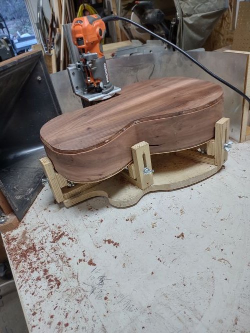

BMB purfing glued to binding.
Binding channels cut. I'll put a description of the binding router set I put together in the tool section.

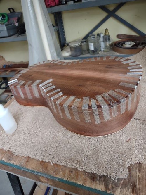

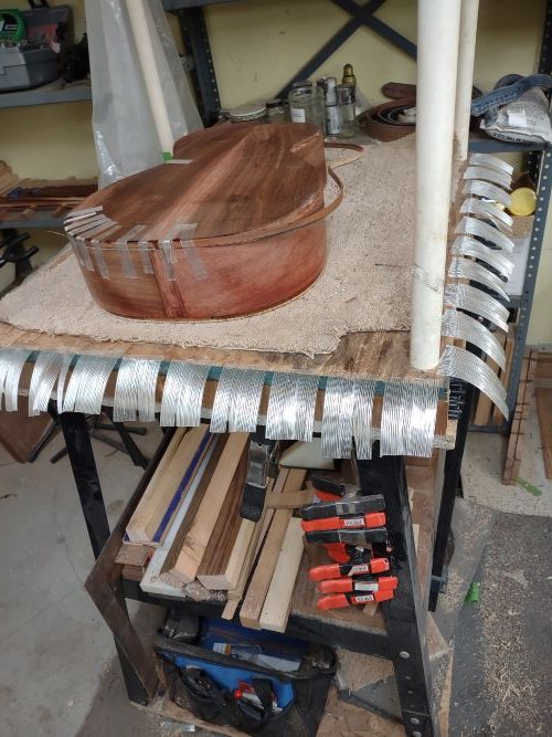

Getting ready for taping. I use reinforced strapping tape split into 4.
Ready for CA glue. Kevin does it this way too.

Nice progress Carl.
I've used the strapping tape too and it works really well. I'm out of it right now so I've still got some Stewmac binding tape to use up.
