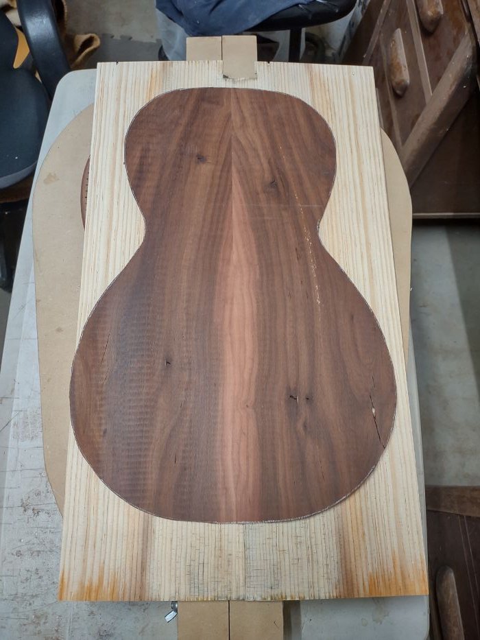

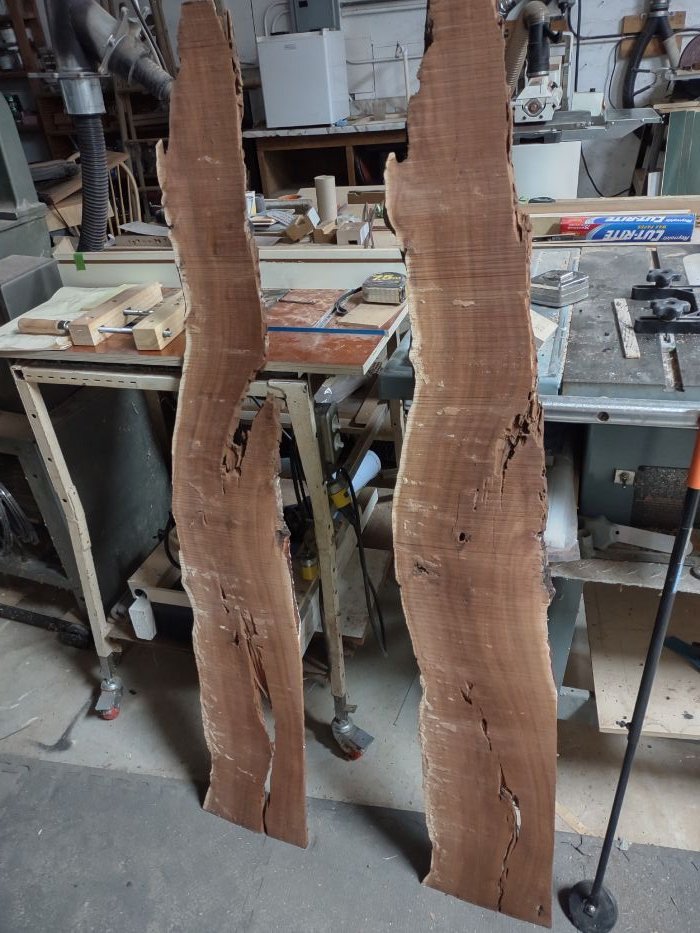

A neighbor gave me a Manzanita log that was long and straight enough to get several slices using my bandsaw mill that yielded back and side pieces. Here's some outside slices of that process that should yield several fretboards, bridges and lots of binding.
The back glued up.

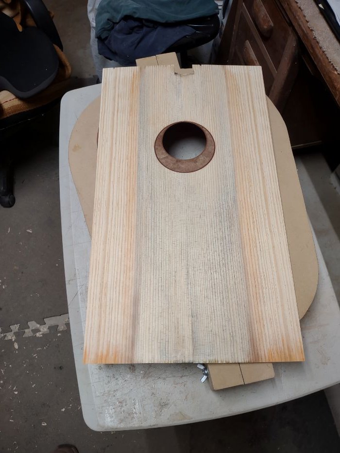

The top is Sugar Pine from beetle killed trees cut down and split into 3" wedges 4 years ago before resawing. Manzanita burl rosette and purfling.

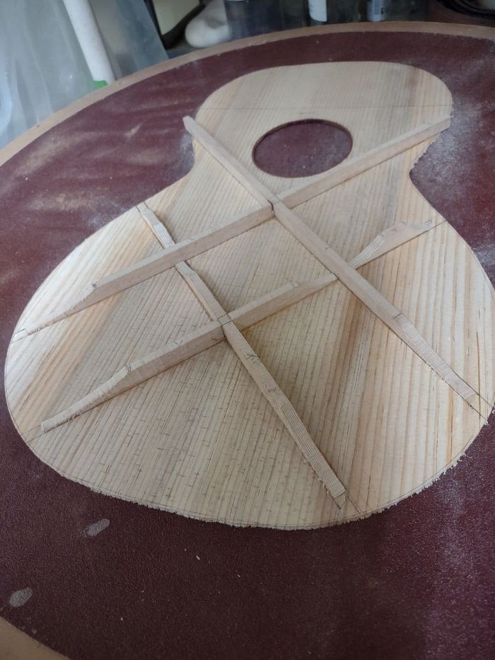

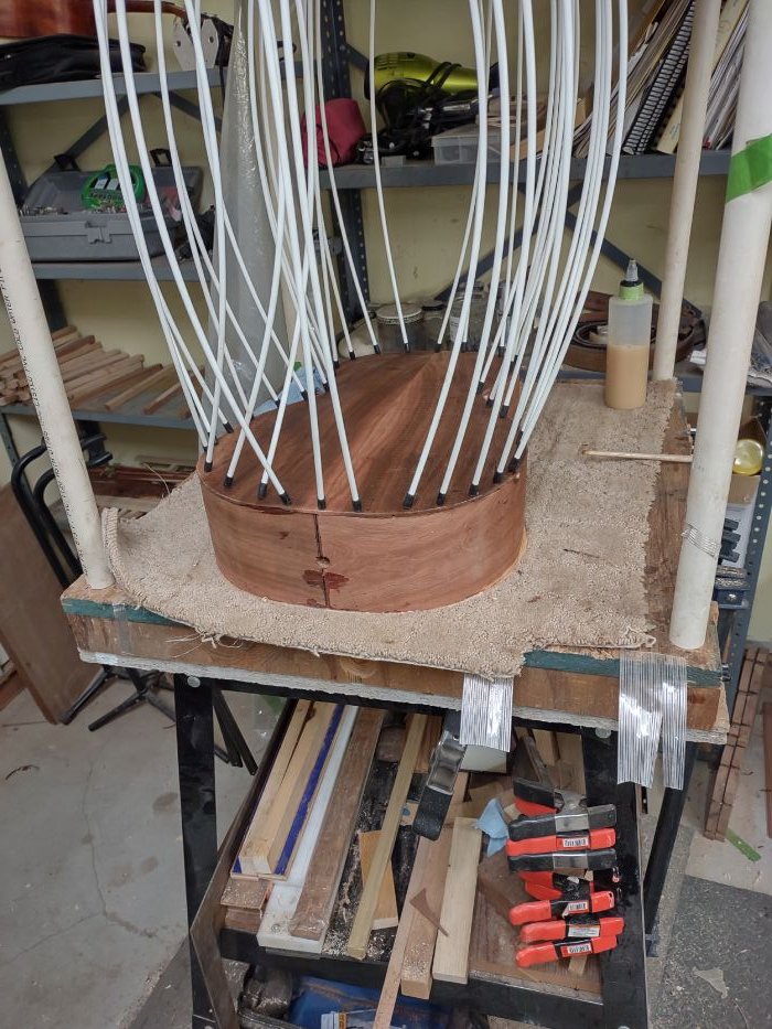

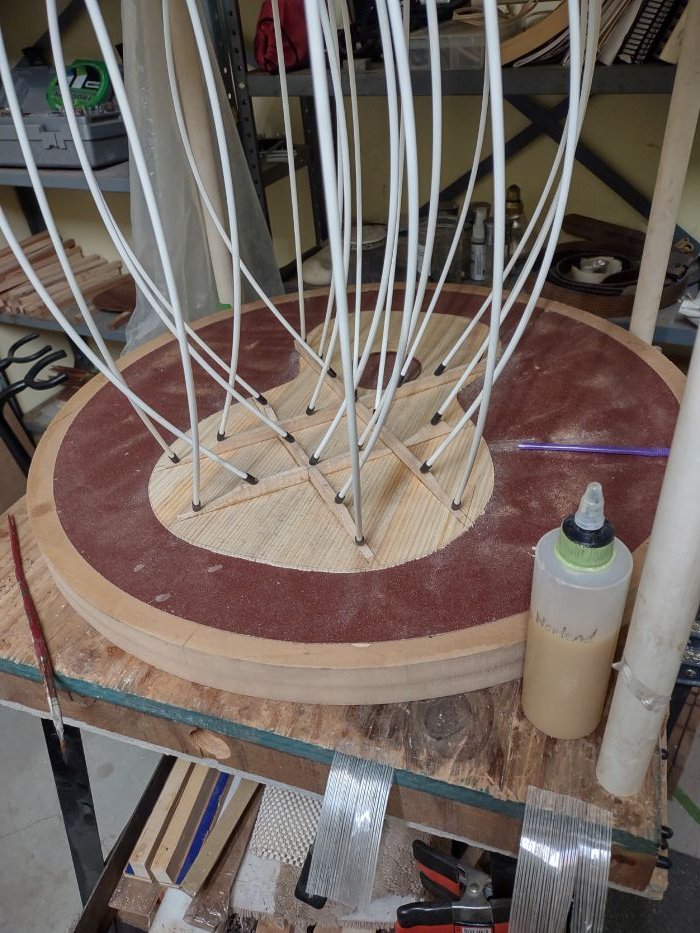

Bracing going on.
I install the UTB into the sides and glued to the neck block extension before the top goes on.
I use a double X-brace (per A. Carruth) and no bridge plate since I use a pinless bridge.

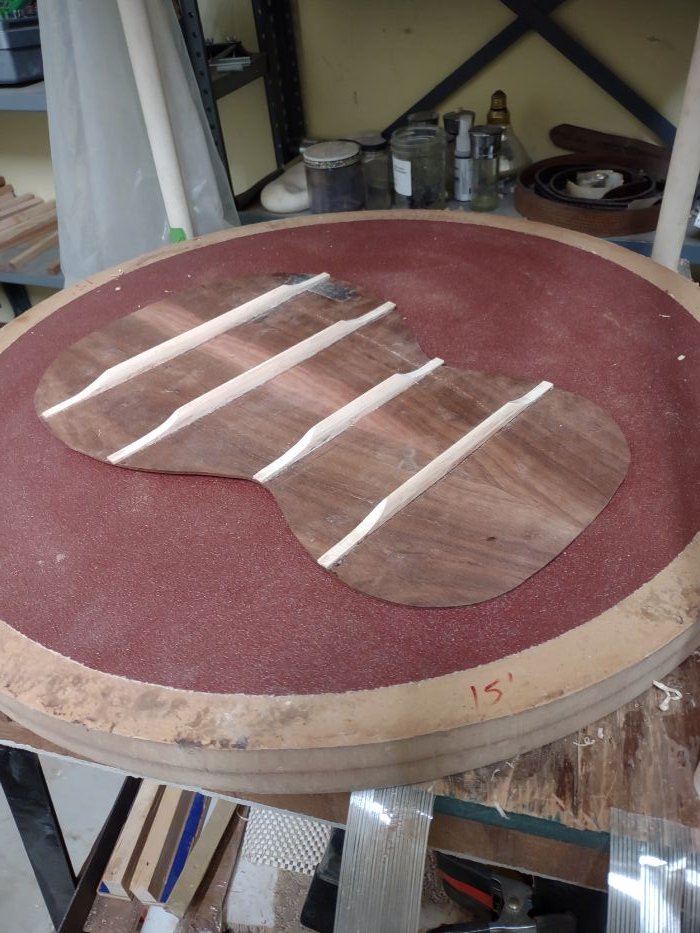

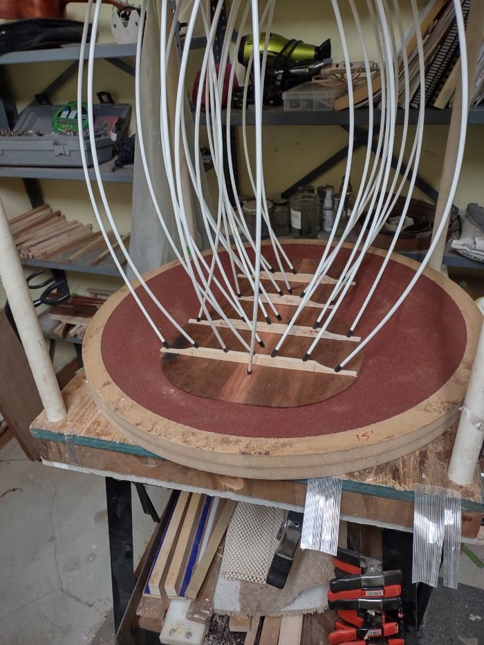

And the back braces.

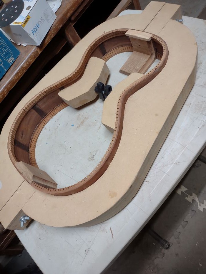

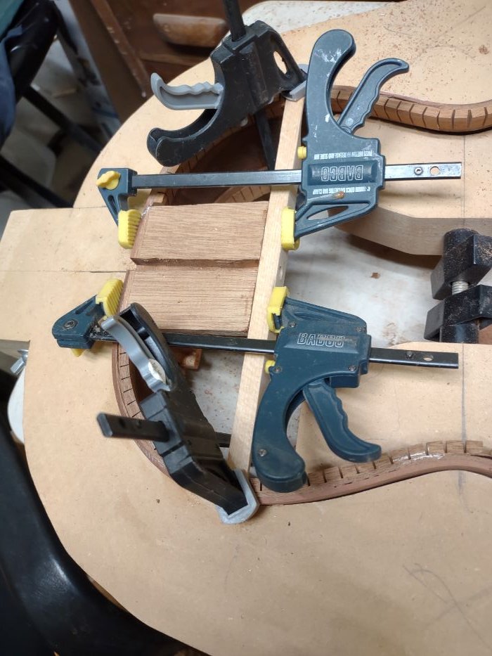

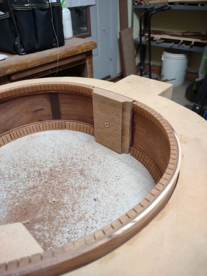

Here's a few details before closing the box. Instead of using a heel to neck spreader, I screw them to the mold. Since I usually do solid layered linings the shape is maintained without the spreaders especially after the top is glued on. Hopefully I don't forget to pull them out before the back goes on.

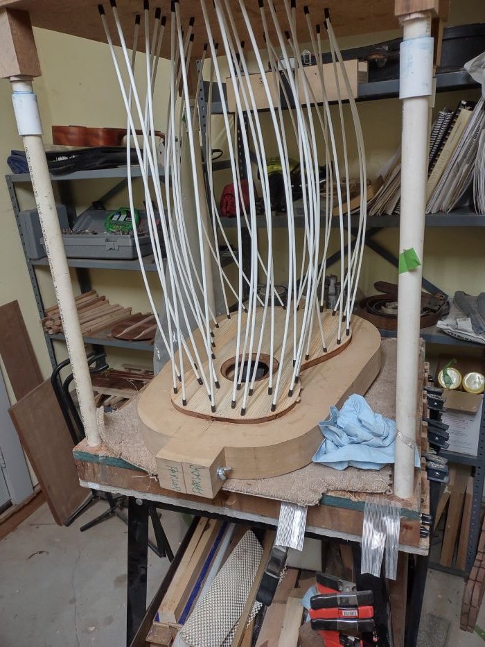

My go-bar deck has blocks that I can change to increase the deck-to-top spacing to allow for body thickness. Top on!

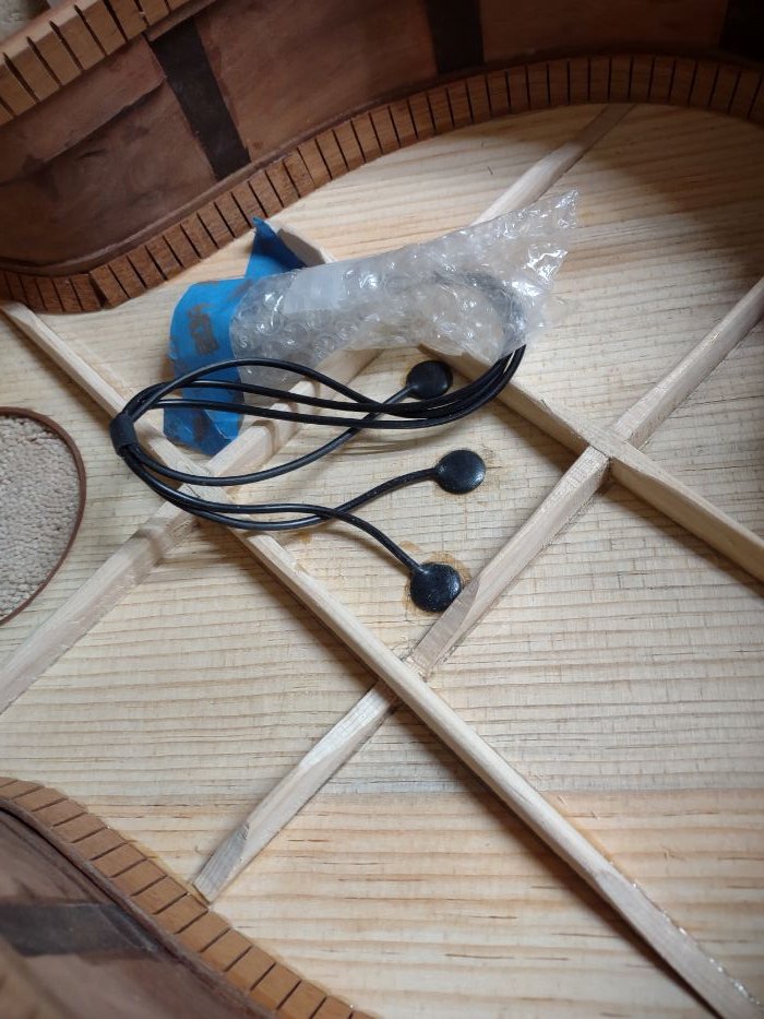

Since I can't get my fat old hand in the soundhole and I use a vacuum bridge clamp, a JJB 330 is installed next before the back is on.

Post by peter havriluk » Fri Jan 30, 2026 1:17 am
Learn something new every day. The pickup's transducers don't have to be glued to the bridge plate? If that's true, it sure would make installing them dead easy. I could install then before the box is closed up.
