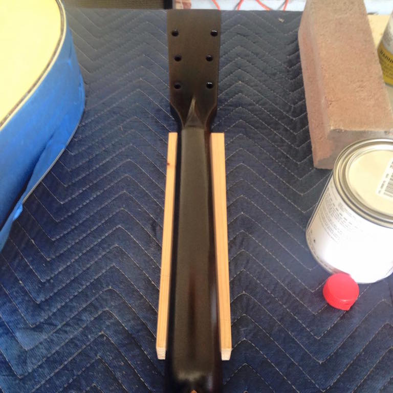

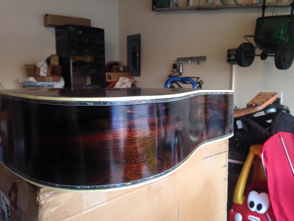

Hi all,
Well,
I am still finishing. I got a bad run on my final coat on the soundboard, and tried to sand it out too soon. So.....
I sanded it back to wood taped the back and sides and redid the top. I was out of Cardinal and I went to wood craft and bought some Behlen. The Behlen seems to lay down better out of this gun for me. I have my three coats 1 hour apart. So a few more days in the paint booth. I couldn't get that mahogany neck to stain where I liked it after pore fill, so I used some Behlen Jet Spray extra dark walnut to even out the darkness. The photo looks dark but no darker than my dad's D-45.
Live and learn. I was bound to make an error. So what did I learn that you all know but someone else might read?
Don't get in a hurry. Thinner coats are better than thick ones. and most importantly no matter how tempting it is to try to stop that run. LET IT DRY COMPLETELY before sanding it and best to spray the back facing up where you don't have gravity working against you.
That's what i learned, maybe someone other newbie like might self might read and save some time. Still I am happy with the final result. The Behlens is laying on like glass. Today in Houston the RH is VERY LOW, so no retarder needed.
Hope you all have a great weekend,

Ya Michael, That's the way things go. Over time I learned it also the hard way. I spray 20! very thin layers and let it dry over 4 weeks. Patience is the key in finishing and there are now shortcuts. But you will succeed, keep going.

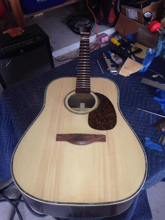

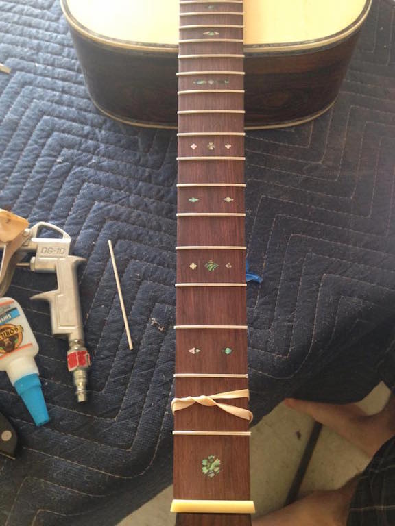

Getting closer. Fretboard done. Frets installed.. Dry mock up before setting bridge.
Thanks for looking,
Mike
Thanks for looking,
Mike
