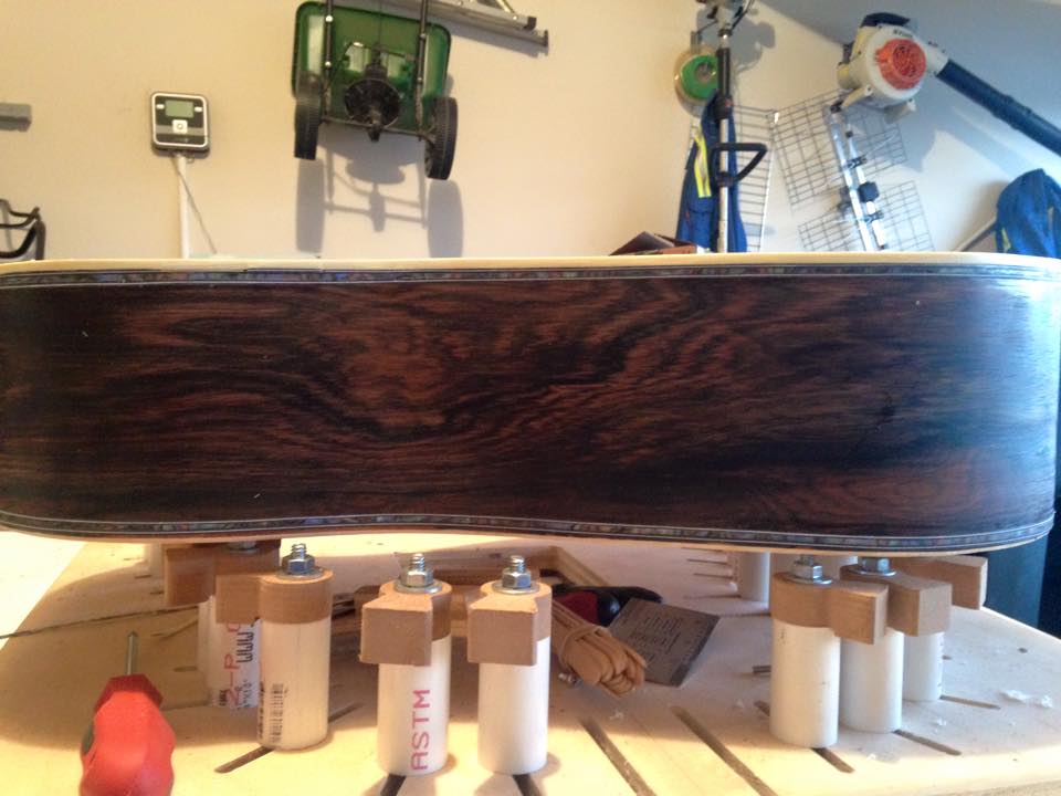

Michael here form Houston. This is my first build. I am almost down with the body. I have had a few challenges, but I expected as so. My biggest challenge is the flat sawn BRZRW back. Lord, I have braced it twice and I thought the second held. But I noticed it is flattening the braces on the lower bout again. I can live with it, it just makes me wonder how much money to invest in the finish, at least on the back anyway.
Thanks for looking.
I had a small nick in the purfling, :(

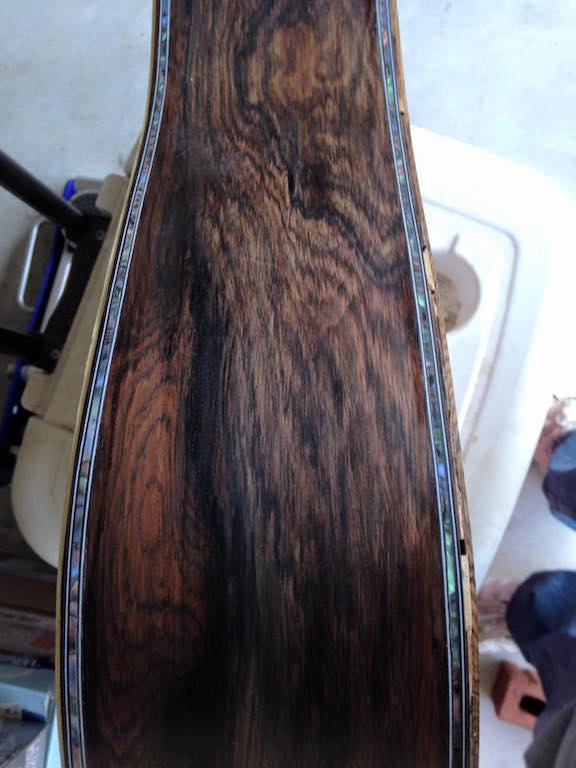

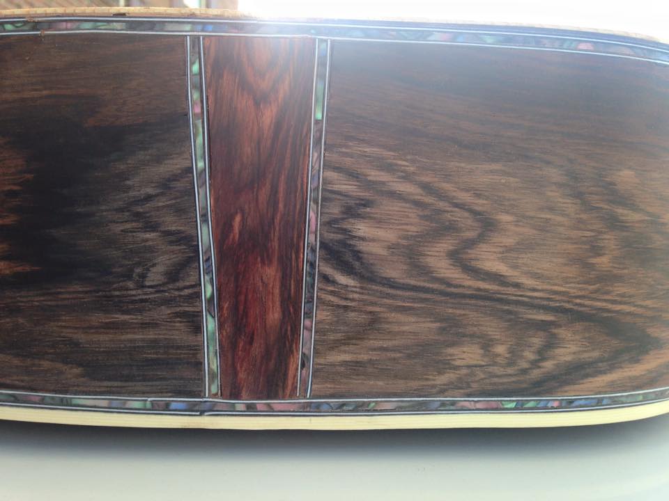

Side purfling installed and back binding. I have to order a new now for the top because I ripped it off because I didn't like it on the back.

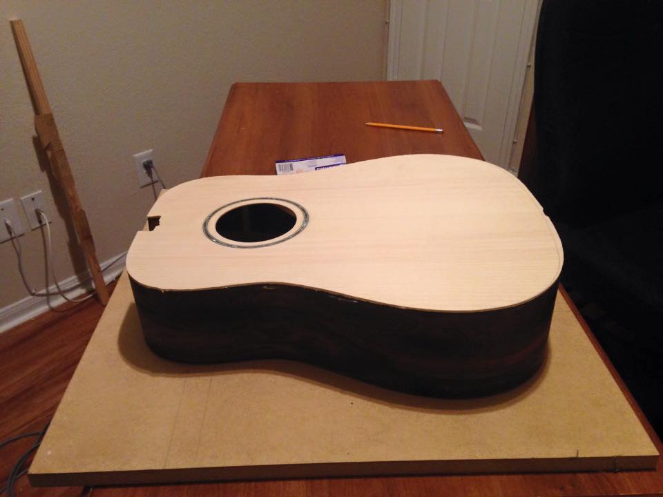

Top glued
Top glued

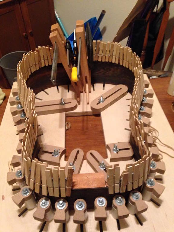

Liner in
Liner in

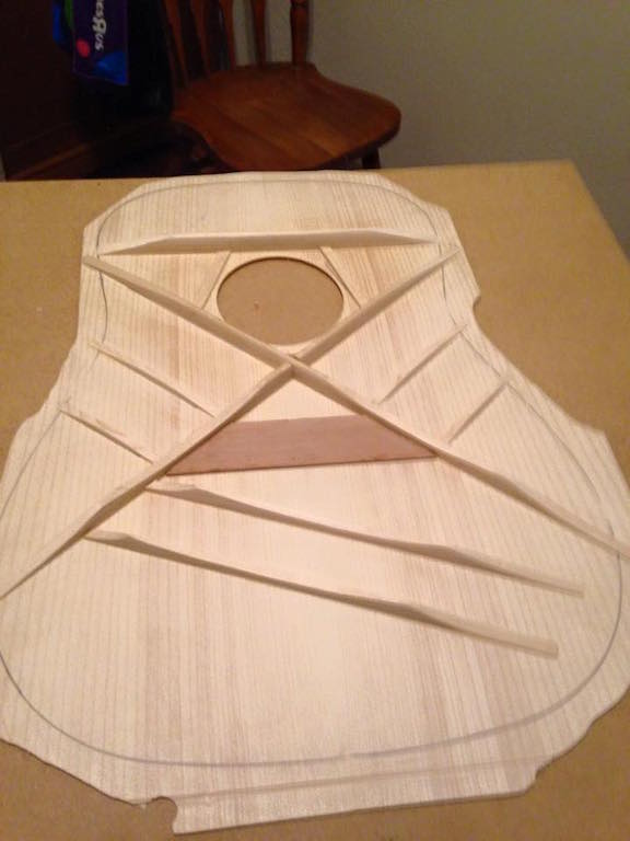

Prewar Adirondack bracing

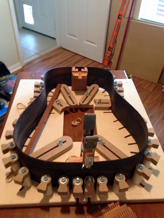

Multi Mold in action

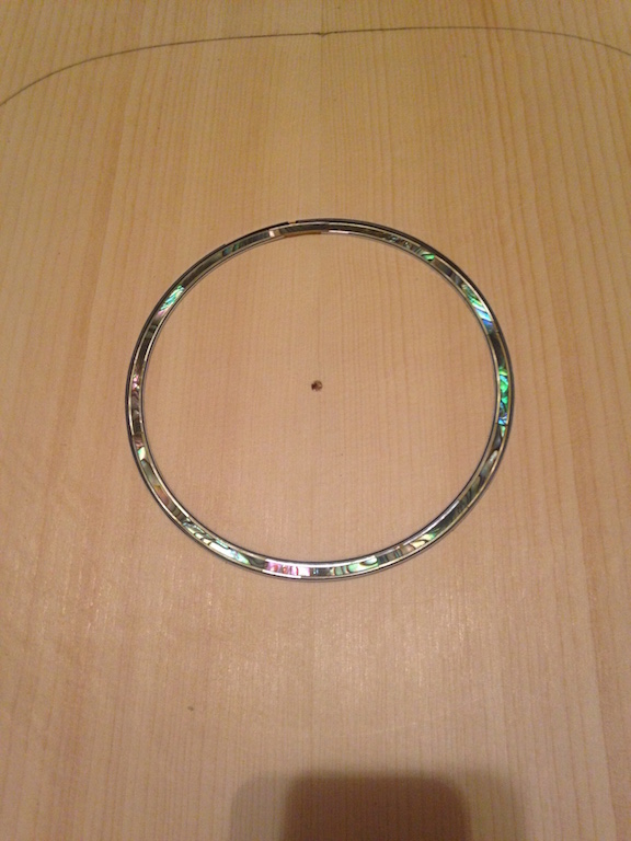

Not too bad for my first rosette

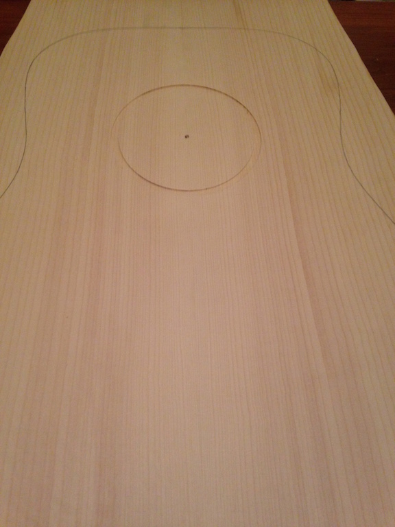

Adirondack spruce
Adirondack spruce

Use a sound-hole and or case humidifier and you'll be fine.
I suggest that one always plans to do their very best work at any stage of the build.
Re: My very first build a Prewar Dread
Post by John Parchem » Sun Mar 29, 2015 11:45 am
The guitar looks good. I do not understand the statement "invest money into the finish" ; it certainly looks like a guitar that it would be worth investing time into the finish. Guitar finishes are pretty flexible so I do not think you will have issues with the finish as the back flatten and domes depending on the humidity level. The dome is on the guitar to allow for the flattening you see as the humidity level changes, this is instead of the back cracking as it shrinks. I would take the time to put a nice finish on. Looks like you can have a spectacular looking guitar.

It is a wide. I ordered some from Stew mac. I should haver followed Ken's advice and order them from Martin, but I was impatient and didn't want to wait 2 weeks. I did not scallop them at all on the lower bout. I though I made a mistake the first time my not using the proper radiused caul when gluing. I chiseled them off. When I finished the second time, it was perfect. But the lower bout, has some ripping at the heel where the high figuring is.
I was worried about how this back moves about the finish cracking. You can almost watch this thing move. But....

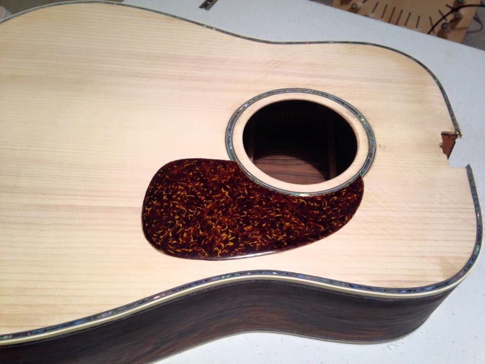

I finished my binding job. I am not completely satisfied, but I am content. For my first try at this, I have performed better than I though I could from a scratch build on my first try. As soon as I get my neck from Andy, I can move forward. I am getting excited to get to the next step... (pick guard is just played on top for photo purposes)
Thanks for looking,
