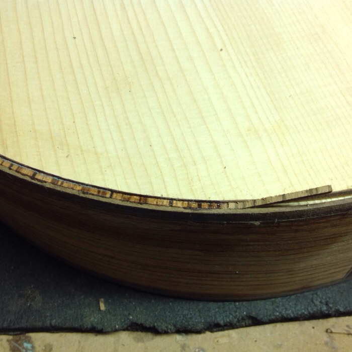

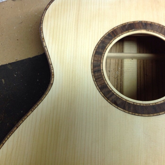

Post by Kyle Barbour » Tue Aug 19, 2014 9:11 am
Some update pics. A little cleaning up to do yet but I'm happy with the results so far.

Post by Kevin in California » Tue Aug 19, 2014 9:37 am
What a great combination of woods Kyle. Looks great! So tell us how you did the wood purfling. I was just yesterday considering, maybe, possibily, even intentionally trying this on my current guitar build.

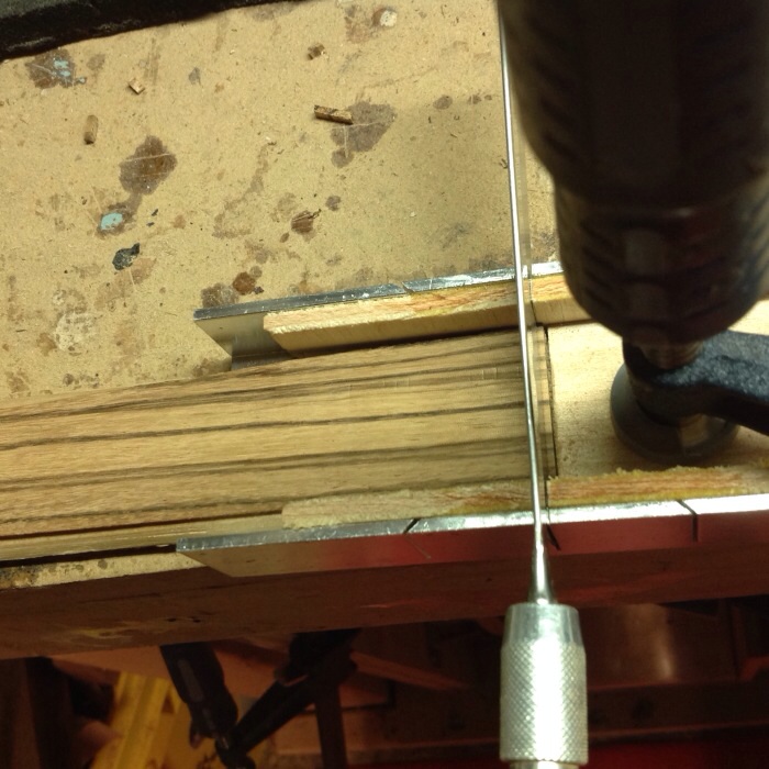

Post by Kyle Barbour » Tue Aug 19, 2014 9:53 am
Thanks Kevin. I cut the wood purfling using a cheap Xacto miter box and saw. Here are some pics of the set up and installation. Once the strips are cut it goes in just like shell purfling strips, break into place.
