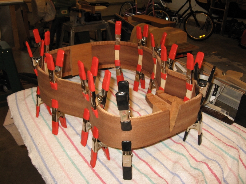

Won't be blogging all of this but I will show progress pics. This is Honduran Mahogany and will have a Sitka top. 1 3/4" at the nut, 2 1/4" bridge spacing, 24.9" scale. I'm a ways along as I put in the side reinforcements today. Will be starting a 00 style next week - Cedar top, Eastern Black Walnut B/S and of course I will be finishing the J-45 (J-50) next week.
1 Side Braces Installed.jpg (439.88 KiB) Viewed 1749 times

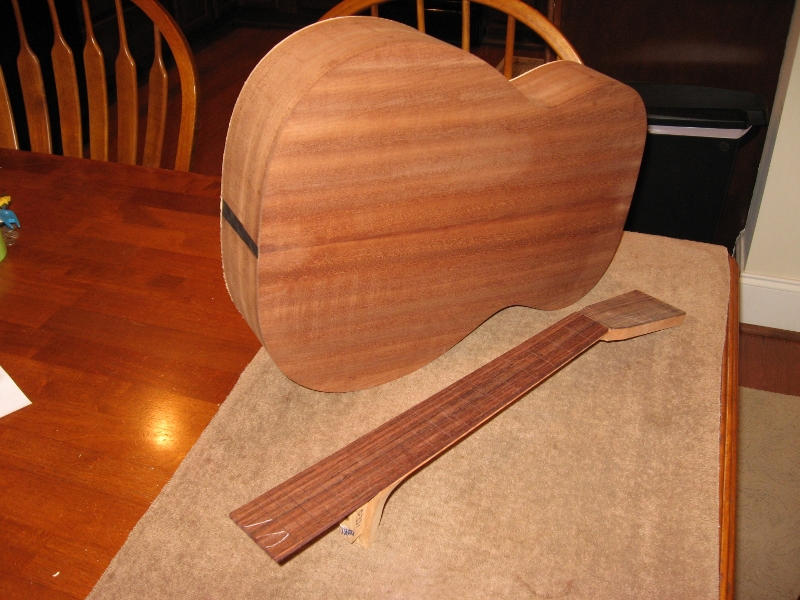

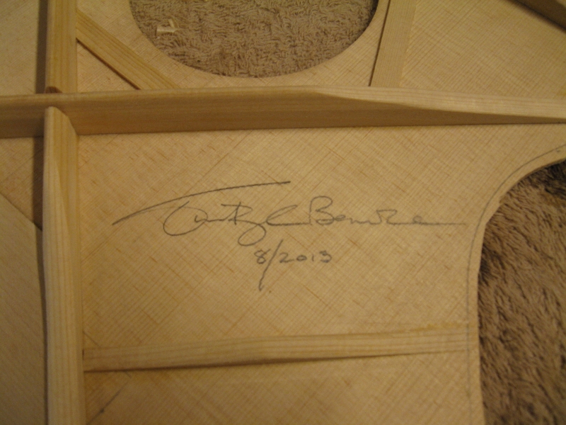

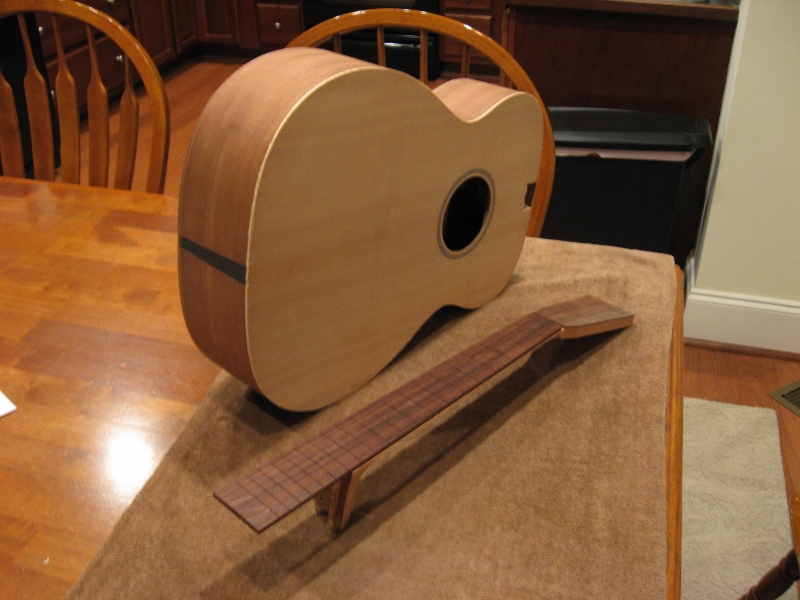

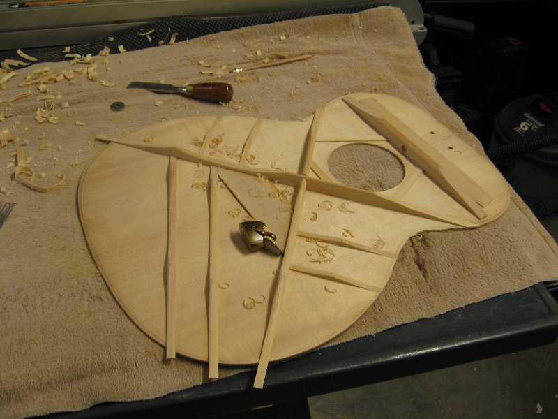

Got a little more done. Box closed, FB slotted and tapered.
2 Top Braces.jpg (404.65 KiB) Viewed 1692 times
3 Signature.jpg (370.38 KiB) Viewed 1692 times
4 Box Front.jpg (382.33 KiB) Viewed 1692 times
5 Box Back.jpg (423.03 KiB) Viewed 1692 times

dave d wrote:Beautiful - I love the look of that mahogany.
Thanks Dave. I think it's the nicest piece I've worked with. It looks a little blotchy now but when I wiped it down with naptha it really presented nicely. I think it's going to look really good under finish.

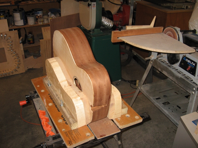

Into the Troji it goes for side scrapping and sanding. I'll cut the binding channels after lunch (which for me is in about 12 minutes:)
6 Side Scrapping.jpg (412.93 KiB) Viewed 1674 times
