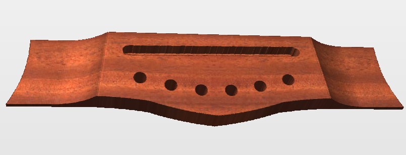

I finally pulled the trigger on a small CNC machine, a Genmitsu PROVerXL 4030 V2. I had always feared the CAD part of it so I tried the free trial of vcarve and drew out a Gore style bridge and simulated the tool paths.
Using just 2.5D there is some limits in terms of 3D profiles. In this case sloping the block top to bottom. Instead I etch some lines and finish up by hand. To test the process I cut out a bridge in poplar practicing a bit before I carve the rosewood.
