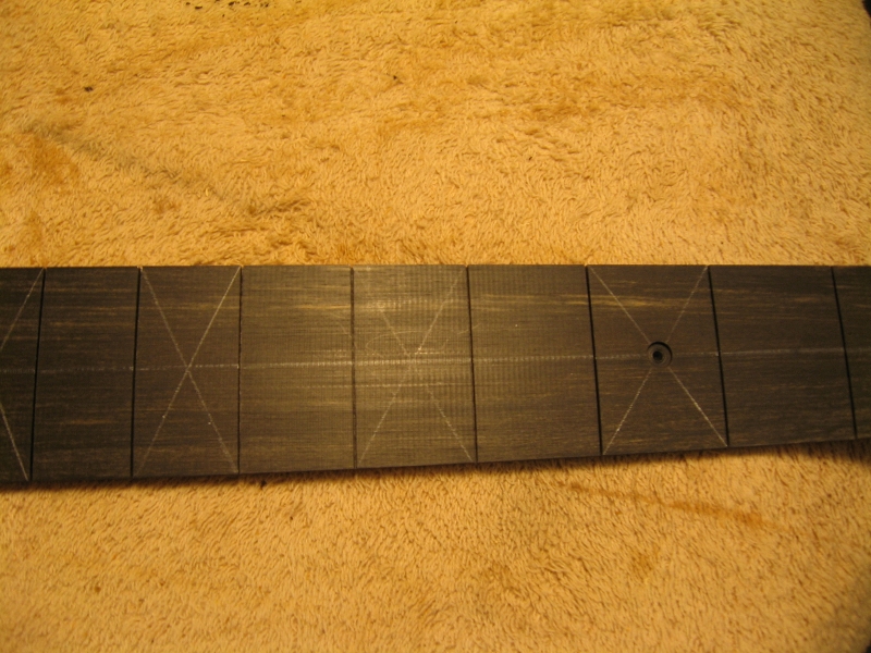

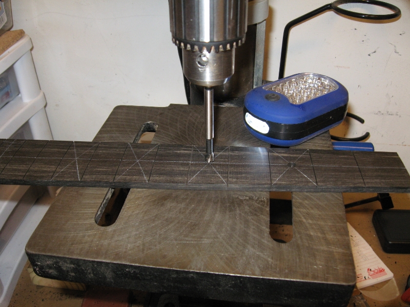

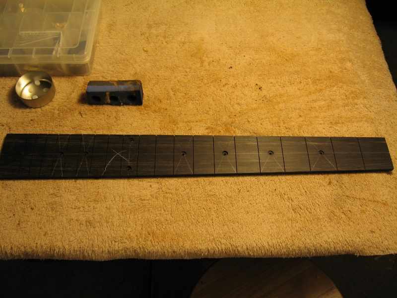

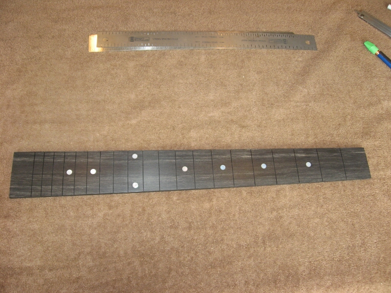

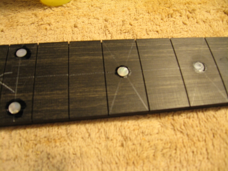

Fret board markers. This happens to be an ebony board with striping. I'm growing to like the look of this very much.
- 31 Drilling Fret Marker Holes.jpg (391.37 KiB) Viewed 1782 times
- 32 Fret Marker Hole #1.jpg (430.46 KiB) Viewed 1782 times
- 33 Holes Drilled.jpg (443.54 KiB) Viewed 1782 times
- 33 Super Glued In.jpg (378.61 KiB) Viewed 1782 times
- 34 Sanded and Complete.jpg (487.26 KiB) Viewed 1782 times

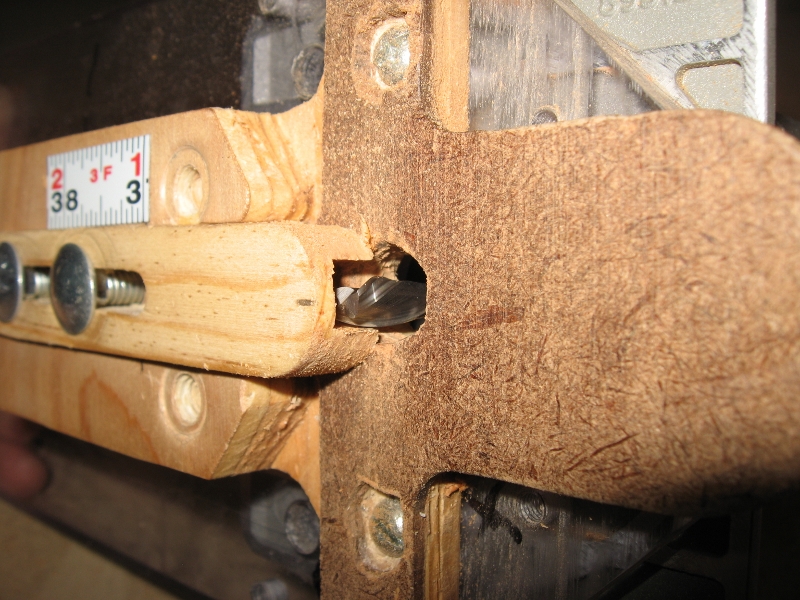

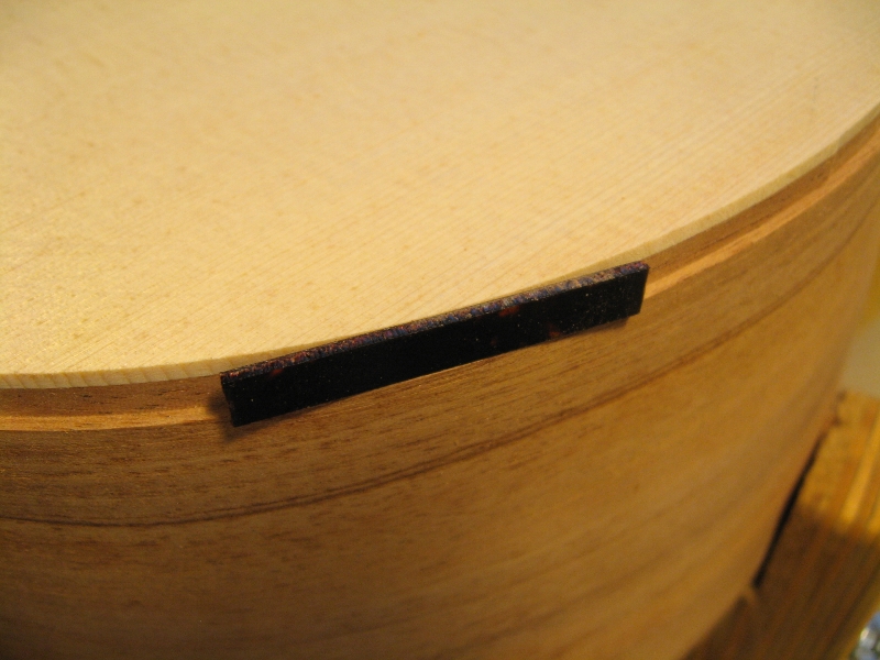

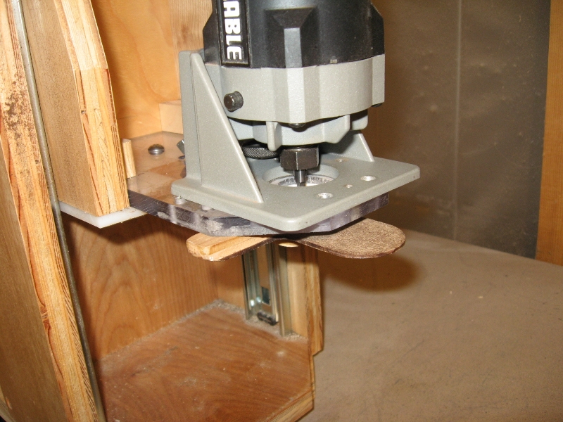

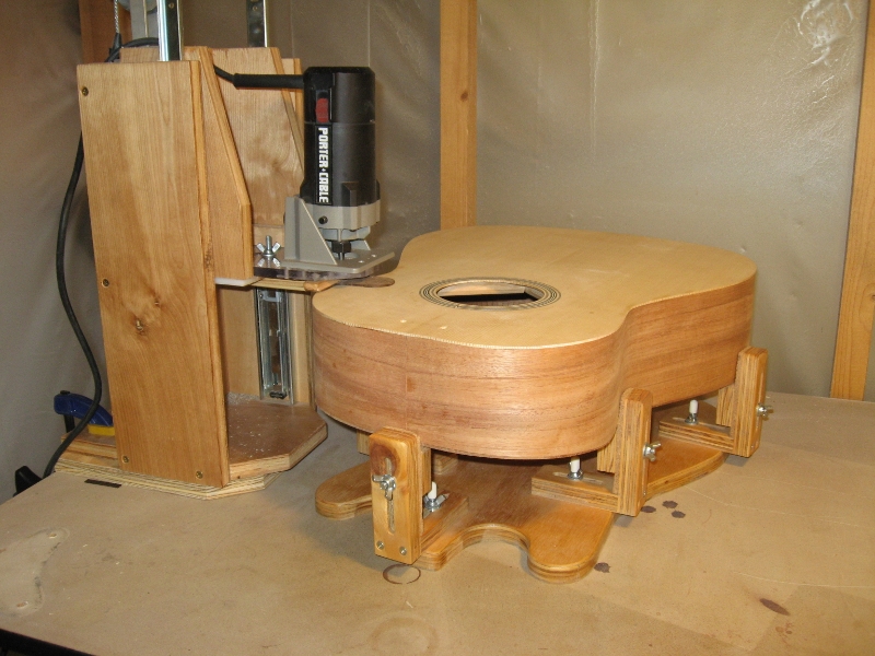

Cut the binding channels, single tortoise top and bottom. I'm not sure if I posted this before but this is my setup with Ken's handheld system that I modified for my tower. It works great. I couldn't ask for cleaner, more accurate cuts than this and I won't!
- 36 Binding Router Setup.jpg (398.98 KiB) Viewed 1776 times
- 37 Binding Router Setup.jpg (387.13 KiB) Viewed 1776 times
- 38 Top Channel Cut.jpg (345.52 KiB) Viewed 1776 times

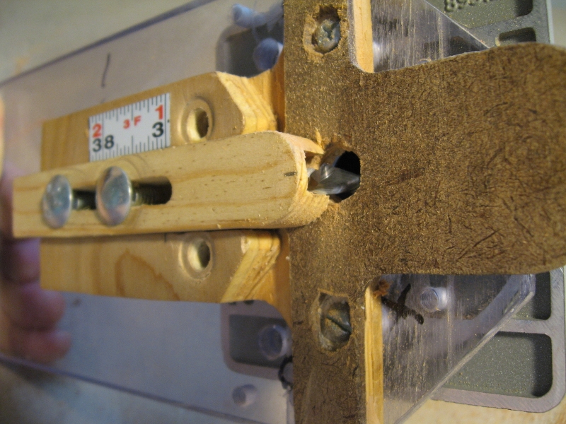

Tim, could you post a picture of that jig so we can see under the plate holding the router? I have one of Ken's jigs and a tower from John Parchem. Perhaps a marriage!

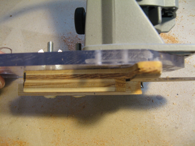

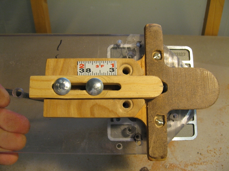

Here tis. I use the piece of ruler for rough sizing to get close. Just cut the long handle off so it runs on the side like a bearing. I tried to hook a bearing on but each attempt i wasn't totally satisfied with.
- IMG_4520 (800x600).jpg (437.23 KiB) Viewed 1769 times
- IMG_4521 (800x600).jpg (415.14 KiB) Viewed 1769 times
- IMG_4522 (800x600).jpg (395.04 KiB) Viewed 1769 times
- IMG_4523 (800x600).jpg (396.56 KiB) Viewed 1769 times

Tim on your routing setup do you move the body around the router or vice versa
Re: My First J-45...
The tower is temporarily fixed in place with a couple clamps and you move the sled around underneath it. I rout from high spot to low spot.5527paul wrote:Tim on your routing setup do you move the body around the router or vice versa
