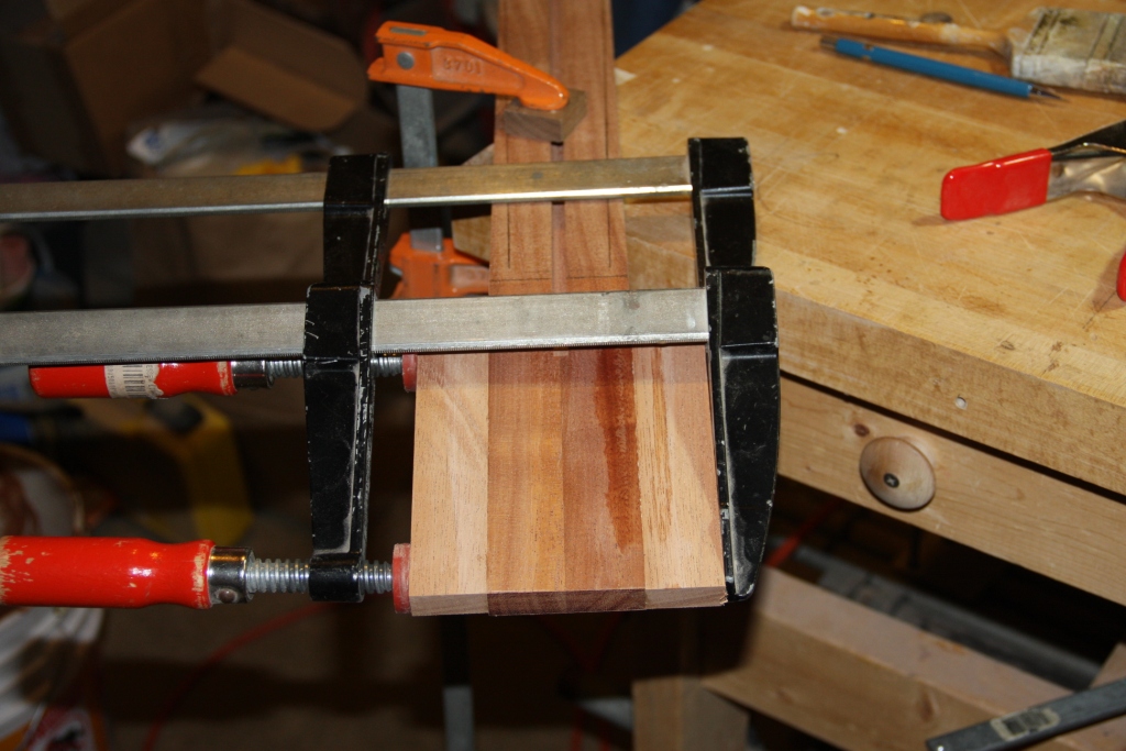

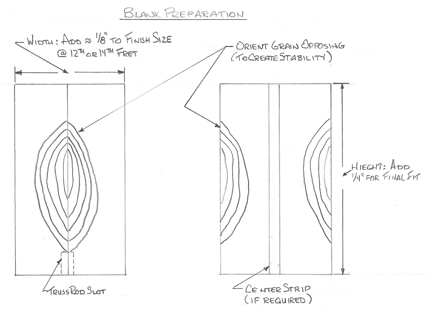

Blank Preparation
In this method I will glue up a blank that can yield either one or two necks. It is more efficient to build two necks from one blank. If not there will be a significant amount of waste. When gluing up the blank you will need to determine the required initial thickness. To do this you will need to obtain the Fingerboard width at the neck-body joint, depending on the guitar design. 99% of the guitars will have a neck that meets at either the 12th of 14th fret. Determine what this width is an add approximately 1/16th or 1/8th. Your total blank, including the center-strip will need to add up to this dimension.
Figure 1.jpg.jpg (479.24 KiB) Viewed 3665 times

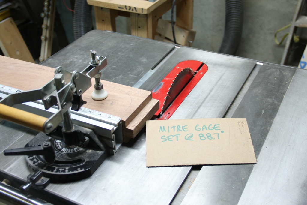

Cut Neck Angle
On a table saw set your Miter Gage to create an 88.7 degree and cut one or both ends as required.
Figure 2.jpg.JPG (323.81 KiB) Viewed 17303 times

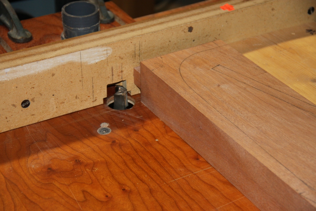

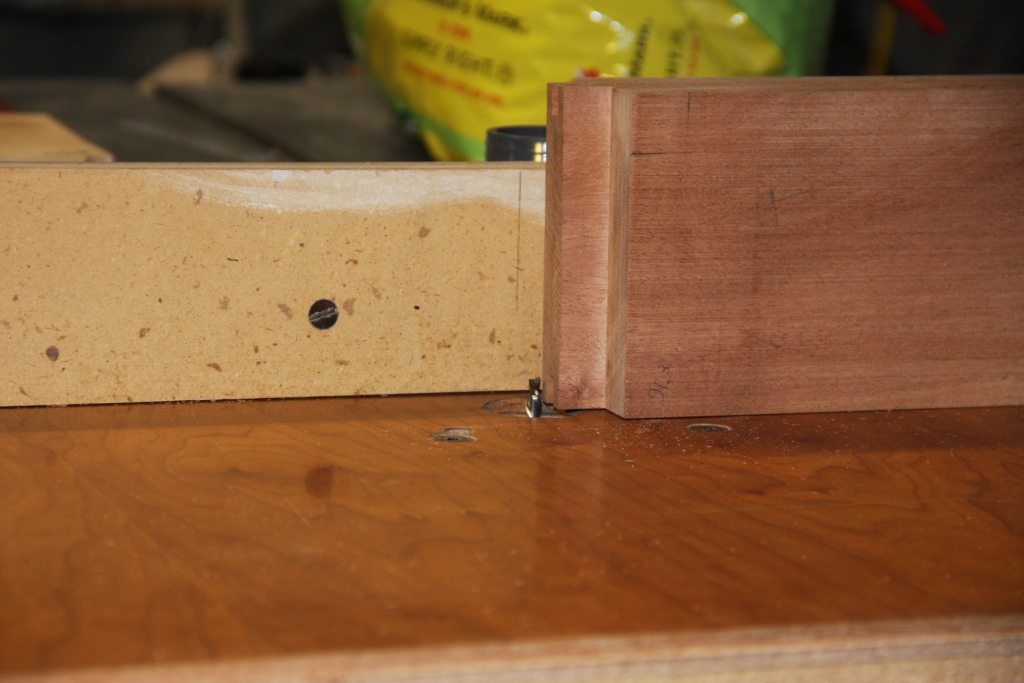

Cut Tenon
On a Router Table cut the tenon to ¾” x ¾”. Make the cuts in a number of steps to arrive at the final dimensions. Make up a backing board that is cut to the same angle’s (88.7 & 91.3 degrees).
Figure 3.jpg.JPG (344.77 KiB) Viewed 17303 times

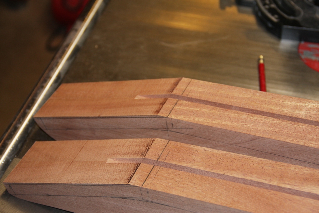

Cut Truss Rod Slot
On the Router Table cut the required Truss Rod Slot(s). The Truss Rods I use require a minimum slot of ¼” wide x 3/8” deep. I typically cut the slot slightly deeper (1/8”) and then later add a filler strip to suit. You can consult the LMII website for more information.
Figure 4.jpg.JPG (292.71 KiB) Viewed 17303 times

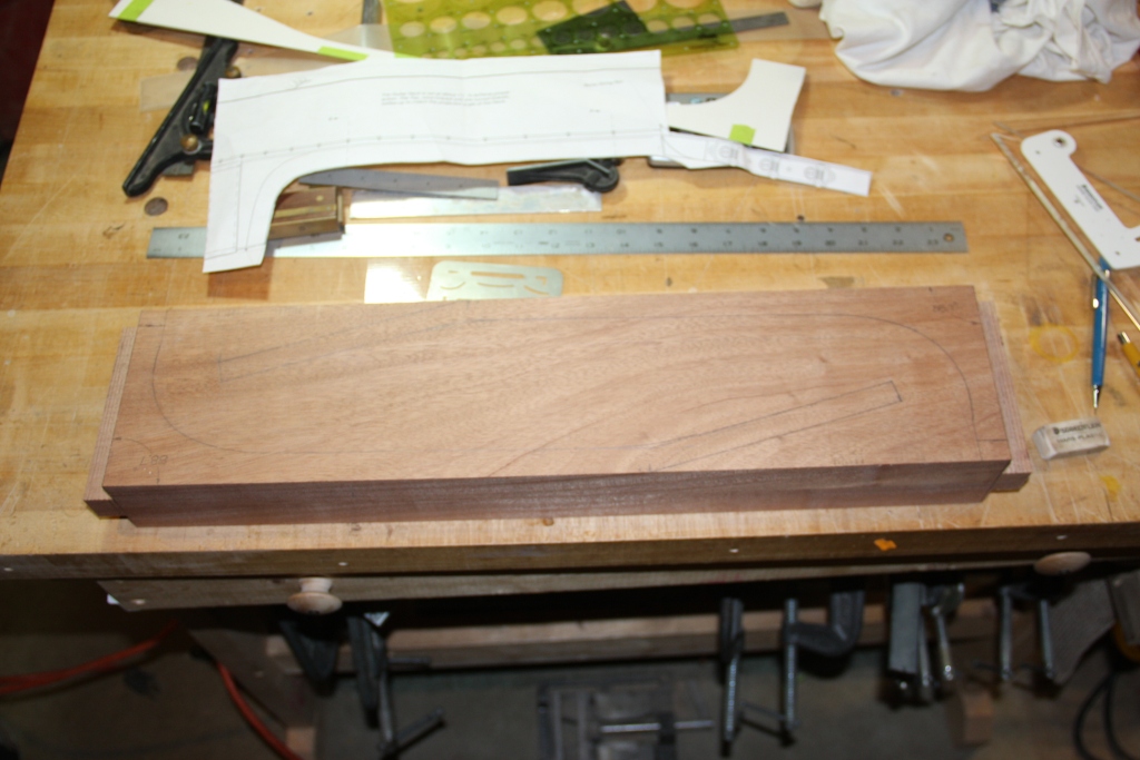

Layout Neck(s) on Blank
Using either a Neck Template or transferring dimensions from a print I will layout the Neck Profile(s).

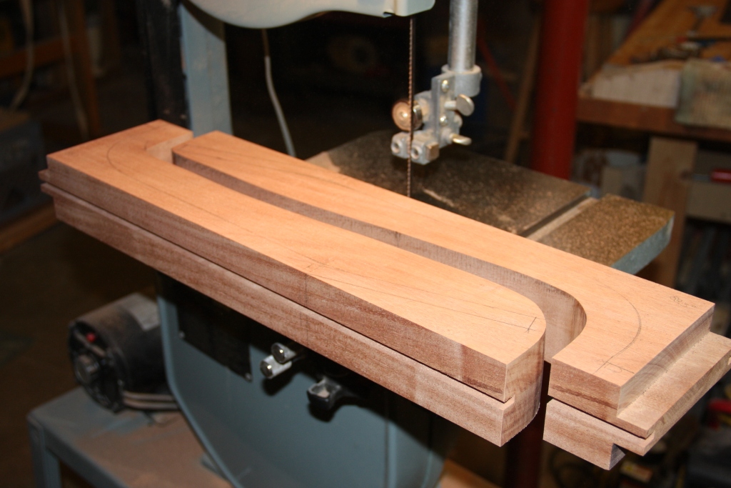

Rough Cut Profile
Using a Band Saw and other methods (Sanding Drum on a Drill Press) I will cut the rough Neck Profile.

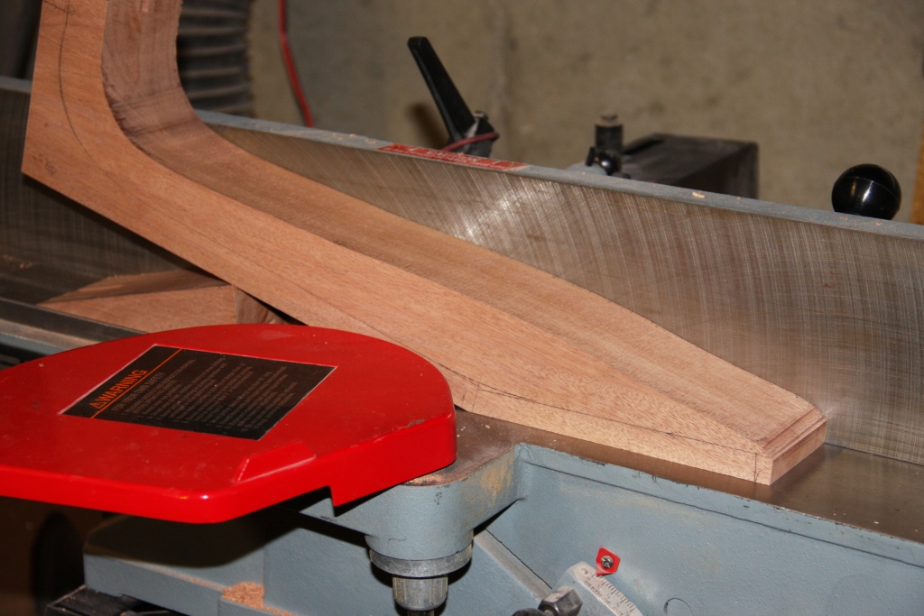

Cut Head Stock Surface
On a Jointer I will cut the Head Stock Face to meet with the layout line just created. Set your Jointer for minimum cuts so that you can “creep” up on the final dimension.
Figure 8.jpg.JPG (330.34 KiB) Viewed 17303 times

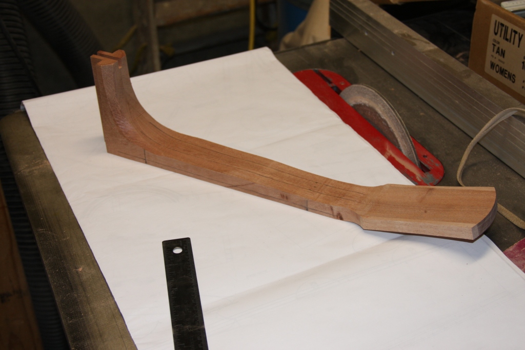

Add Head Stock Pieces
You will need to add one piece on each side of the Head Stock to accommodate the final Head Stock Profile. I thickness the wood slightly thicker than the rough Head Stock and then glue in place trying to maintain a close fit on the front side of the Head Stock.
Figure 9.jpg.JPG (305.66 KiB) Viewed 17303 times

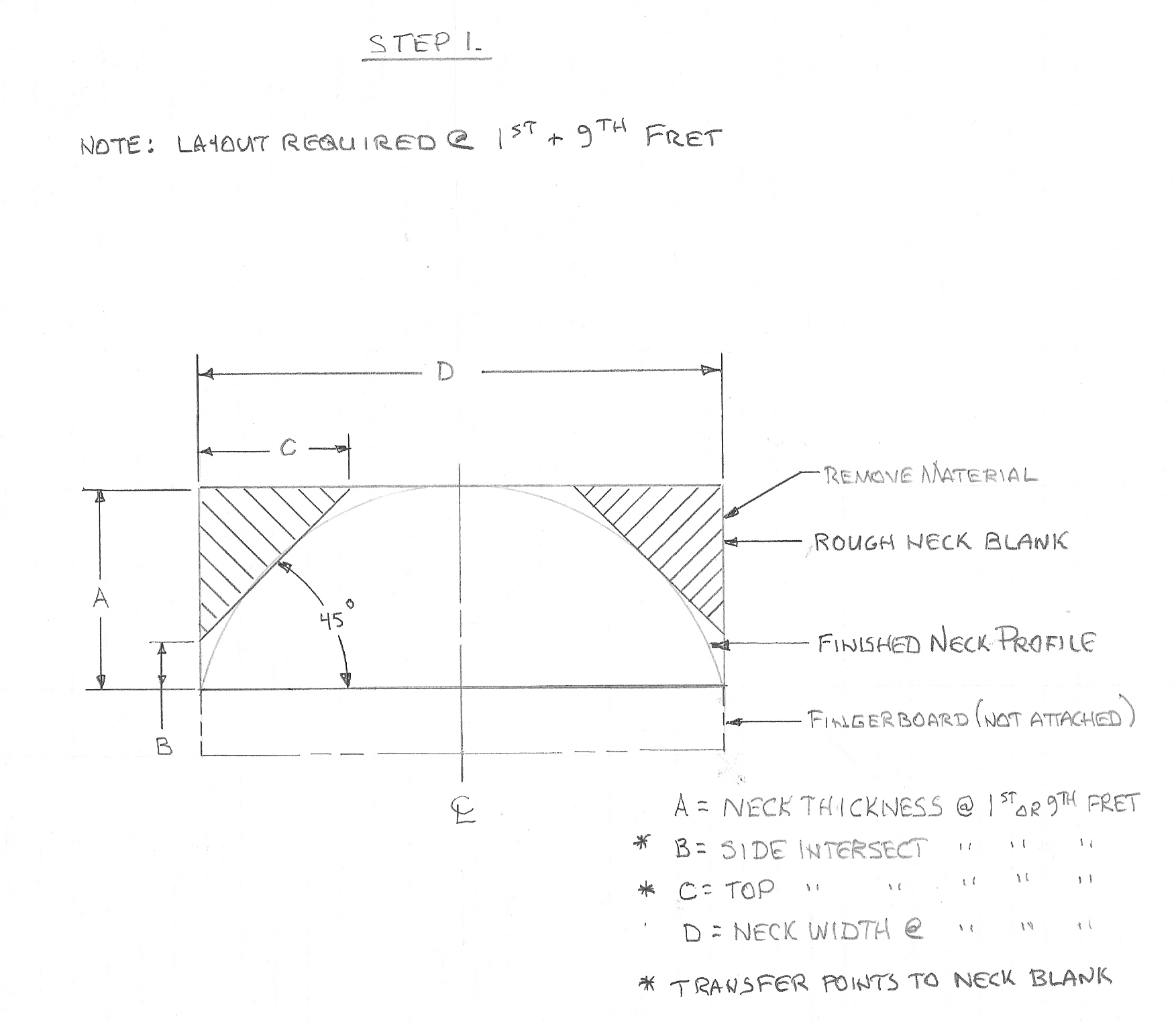

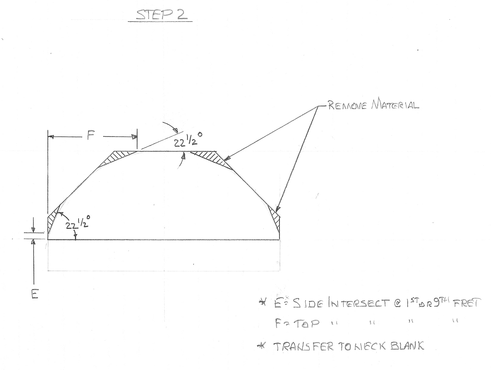

Layout Initial Shaping Lines
Using some basic drafting tools such as a 45 degree triangle you will to determine measurement points that can be transferred to the rectangular section of the rough cut Neck. Additional points at 22.5 degrees can also be added. I make profiles for the 1st and 9th Frets. See the following illustrations. This approach will create a round neck profile. Different profiles such as a “V” style can be created in similar manner. Spend time making your profiles on paper before working on the Neck.
Figure 10.jpg.jpg (397.86 KiB) Viewed 3665 times
Figure 11.jpg.jpg (251.22 KiB) Viewed 3665 times

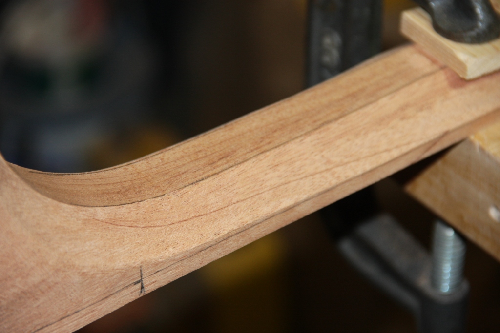

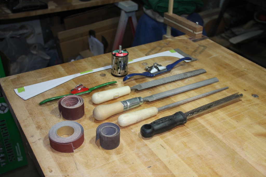

Shape Initial Profile
To cut the initial profiles you can use Spoke Shaves, Wood Rasps, or other devices. Holding the tool at 45 degrees - work to the layout lines. When this is complete hold the tool at 22.5 degrees and work to the remaining layout lines. When complete you will have a faceted Neck nearly round in profile.
Figure 11-5.jpg.JPG (240.44 KiB) Viewed 17303 times
Figure 12.jpg.JPG (248.8 KiB) Viewed 17303 times

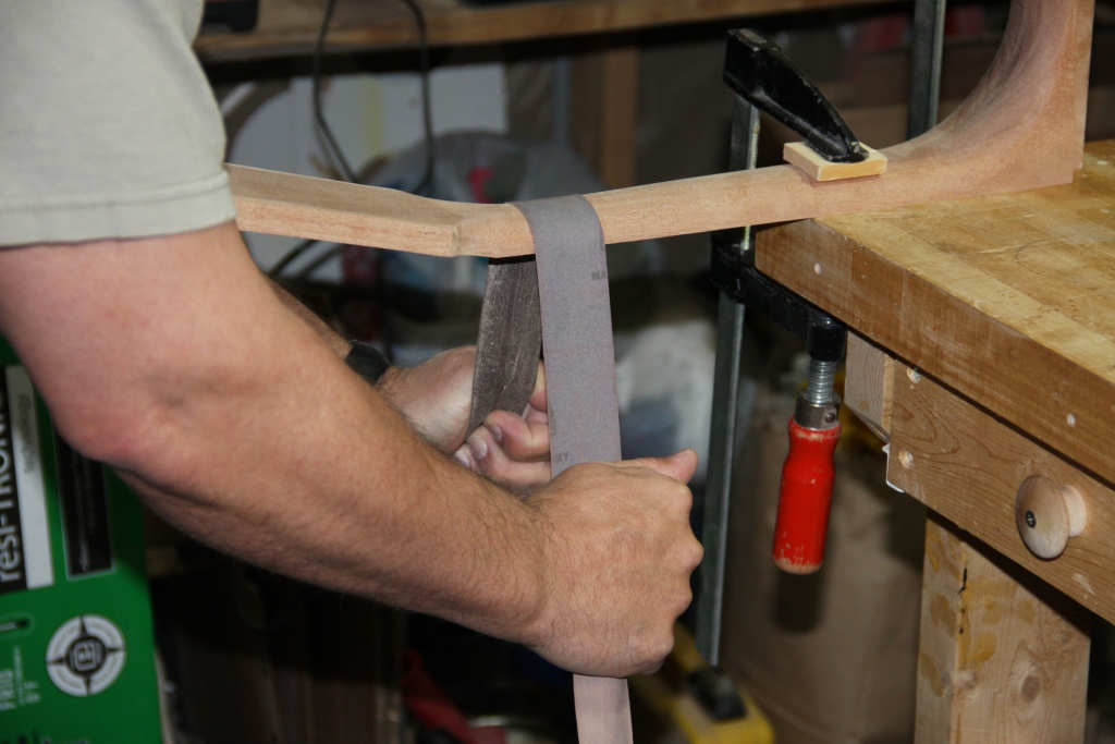

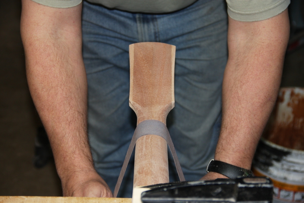

Shape Semi-Finish Profile
To develop the rounded profile you will need to sand the Neck with Sanding Strips. This is done by using a back and forth motion similar to shining a shoe. Try not to remove much wood from the edges as you want to leave some material for final shaping after the gluing of the Fret Board.
Figure 13.jpg (278.75 KiB) Viewed 17303 times
Figure 14.jpg (285.86 KiB) Viewed 17303 times

I've got a couple of questions.
First, can you explain this step any further? I'm having trouble envisioning it for some reason:
"Make up a backing board that is cut to the same angle’s (88.7 & 91.3 degrees)."
Also, how would the above procedures differ when building in a center strip of a different wood?
Thanks
dhlutherie
Posts: 18
Joined: Thu Dec 15, 2011 1:18 pm
Re: Acoustic Guitar Neck Constructions - Laminated Type
Post by dhlutherie » Tue May 22, 2012 4:10 am
The Backing Board is used for two reasons. First, it provides a means to push the neck glue-up across the router table, insuring that it is also against the fence. Sort of like a mitre gage without a slot in the table. Second, it backs up the neck glue-up to minimize tear-out at the end of the cut. This is typical when routing, especially with cuts perpendicular to the grain. Remember that you will have cut the end's of the glue up to match your desired Neck Angle. On one side you will have 88.7 degrees, flip the glue-up over and you will have 91.3 degrees. The backing board needs to have identical angles so that it will in perfect contact with both the Neck Glue-Up and the Router Table Fence.
One other recommendation: Make your Neck Glue-Up slightly wider (taller) than what you need. By doing this you can run the glue-up over your Jointer to remove the Routing Tear-Out.
Center Strips are just another layer added in the Glue-Up. I have done both one and three ply Center Strips. Make sure to keep your boards oriented properly. This information is included above, but it does not show with the other pictures - you will need to click on the attached link.
Let me know if this answers your questions.
