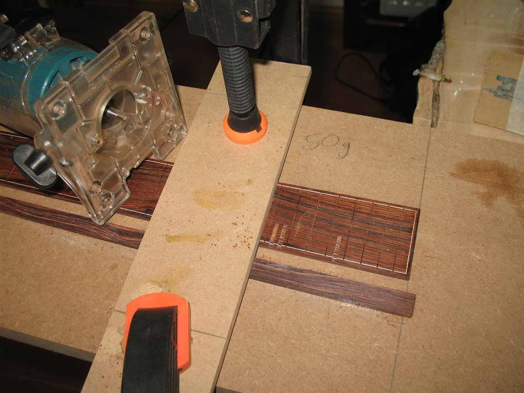

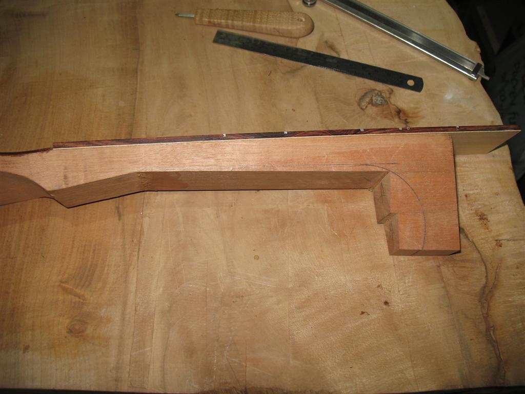

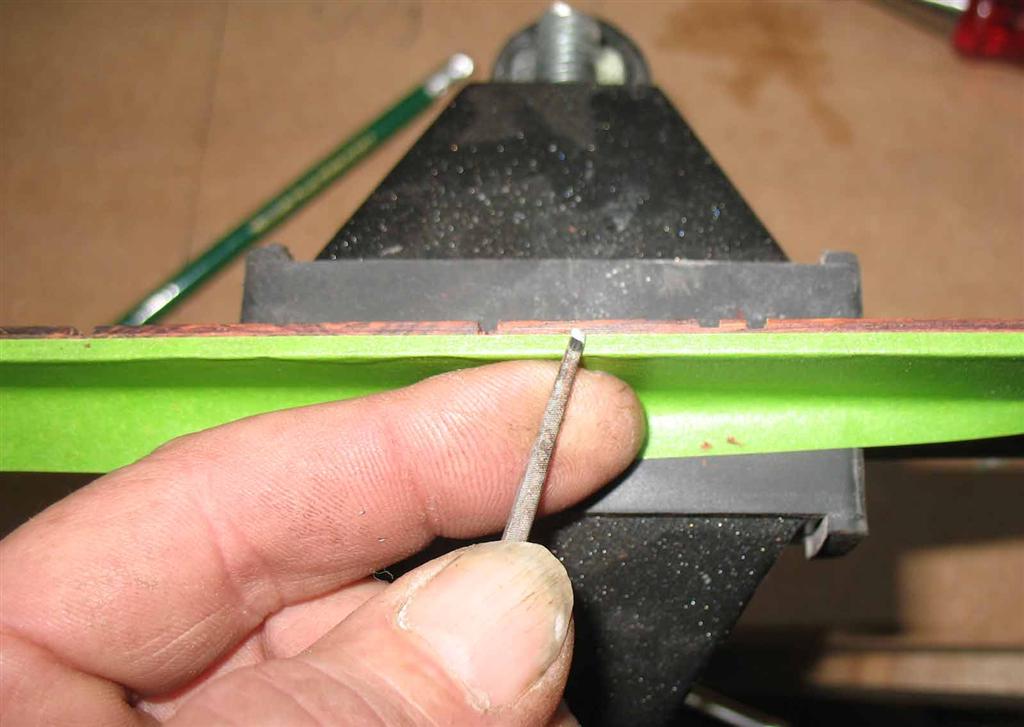

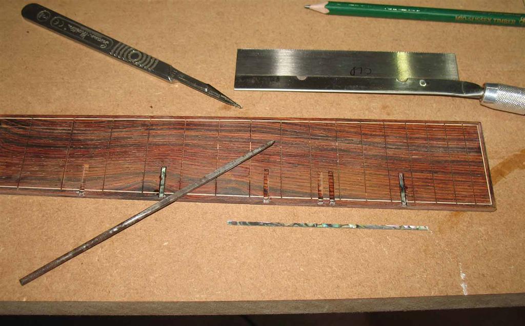

Where as you use full height side markers, mine are only half the height of the binding (can't find a pic atm). I stick the side bit in first to get the full effect of the shell as a side marker, the top of the marker has a tiny bit of shell end grain on the edge of the fretboard, but this doesn't show unless you put on the 4 x magnifiers :)
I did try mitering the shell pieces when I first started using this technique, but it was so unbelievably tedious and the results were no better.

Found some pics :) but in reverse order.

Thanks for the additional pics! Clears up a few questions!
