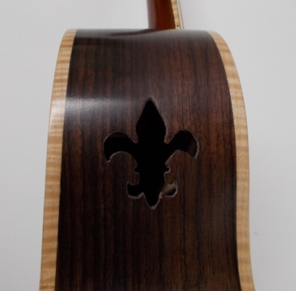

I have a question for all, the Norman Blake has a smaller sound hole than a normal OM,
Now if a guy wanted to add a small side port. Would you have to make the body a tad bit wider to make up for the extra side port? If so is there a formula for this? Or could you just build a wide body and put a regular 000 sound hole?

Regarding the sound port -- what is it that you hope the sound port accomplishes?
Re: Jack's number 4- KMG Norman Blake 000-12 finished
You don't need a wider body to add a sound port. No sense in dealing with formulas for that. A shape that roughly contains 1.5" x 1.5" to 2" x 2" should work just fine. This is my latest (2" x 2") and it's in a 00 sized body.Michael_K wrote:Beautiful guitar. When my stencils come in I will start on one of these.
