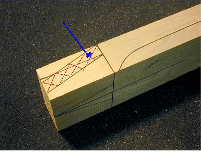

That's where the headstock is inserted. These pics make this type of neck joint seem less scary. I'd like to try it one of these days.

Post by Dave Bagwill » Fri Sep 05, 2014 4:47 pm
The parallel lines that I've x'd in between seems to have an area outside of where the headstock will plug in?
Re: Bird's beak headstock
Post by ken cierp » Fri Sep 05, 2014 5:35 pm
The parallel lines represent the headstock thickness to make the cutting layout accurate -- check out the demo pic sequence again.
Post by Dave Bagwill » Fri Sep 05, 2014 5:42 pm
Ok, got it. Thx.

Post by Dave Bagwill » Fri Sep 05, 2014 5:55 pm
The "V" joint, which I posted a link to here somewhere and now can't find it, seems to be easier and look fine as well, but I don't know if it is good for steel string guitars.
Post by John Link » Fri Sep 05, 2014 9:43 pm
Is there any real mechanical advantage that the bird's beak or V joint has over a well cut scarf joint?
Post by Dave Bagwill » Fri Sep 05, 2014 10:57 pm
As far as I can tell, nope.
