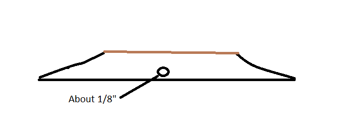

I purchased a 000 kit from KMG some time ago, and am now just getting to the assembly process. It seems the kit did not include the shoulder brace. Does anyone have the actual shoulder brace dimensions for a 000 size, including the hole location and size for the truss rod adjustment?
Re: Shoulder brace dimensions
Post by Dave Bagwill » Fri May 24, 2019 7:24 pm
1/2" wide, 5/8" tall is what my plans call out for.
The hole is of course right in the middle line of the guitar, leave about 1/8" of wood between the bottom of the hole and the top wood.
The hole just has to be big enough for the allen wrench to fit through, it is not a critical measurement.
