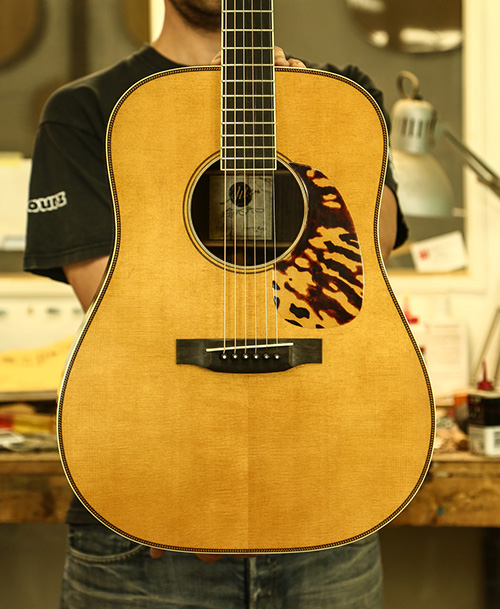

Martin once made a Clarence White version of their D-28 that featured a larger than usual soundhole. It garnered a lot of respect. As John P mentions, it is difficult to service a guitar when the hole is small, absolutely speaking. A number of forum members have experimented with an extra port on the upper side which has the same effect on the top's resonating frequency as using a larger soundhole. I don't recall anyone reporting this to have a negative effect.
Myself I like the "proportions" of the Clarence White model. I don't know exactly how large the opening is (someone who knows might chime in), but will upload a picture of a replica taken face-on, to give you an idea of how the diameter relates to the overall dimensions. The larger hole offsets the tubby look created by the shallow waist of the dreadnought design. In any case, accommodating future repairability is, I think, a good idea.
