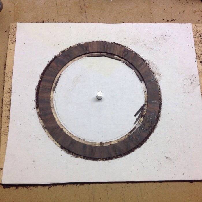

I do rosettes in a similar way. I use a plywood work board. Use some 3M spray adhesive to attach a sheet of paper to the board. I then assemble the rosette using CA glue on top of the paper. When I'm done I just use a thin metal spatula to work it from the paper. Here's a pic of one in progress to help with the explanation.
- image.jpg (137.55 KiB) Viewed 2731 times

Thanks Kyle, that looks like what I need. Do you need to do anything to clean the paper off the back of the rosette after working it loose, or does it come off pretty clean? I think I need it to stick fairly well to the paper so the veneer doesn't come loose with the CNC router.
