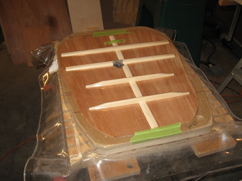

Over the weekend, I braced the back and profiled the braces. I put tape on either side of each brace as I glued it. At first I used some old blue tape we have here. I think it's painter's tape. It didn't come up very well (it stuck to the board and glue too much), so I switched to some of the tape I use for binding. That worked really well. Very little cleanup.
After seeing all the squeeze out from that brace, I went with less on the next one.
Here's the back after profiling the braces.

That's looking good Bob. i"m building one now out of Honduran and Sitka (J-45 style). And it has the low back braces as well. This will be my fourth with those and I like the sound I get a lot. Can't say it sounds better, just sounds good. So don't worry about those.
12 Back Braces In.jpg (395.17 KiB) Viewed 3082 times
