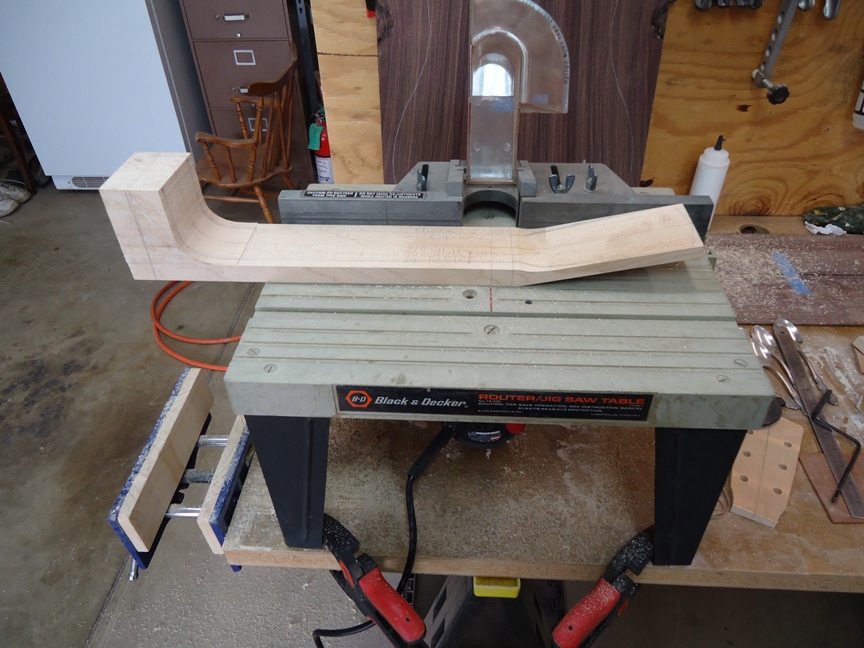

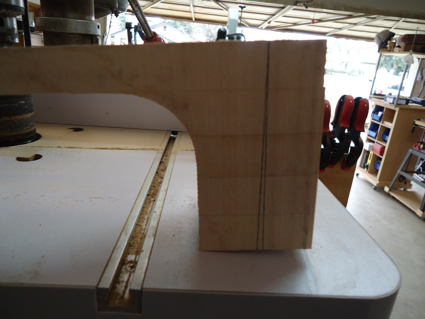

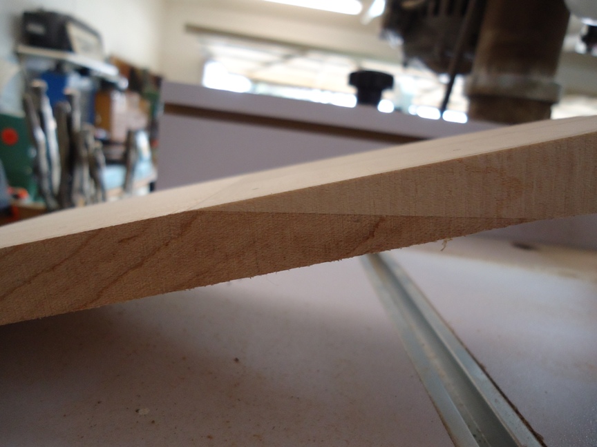

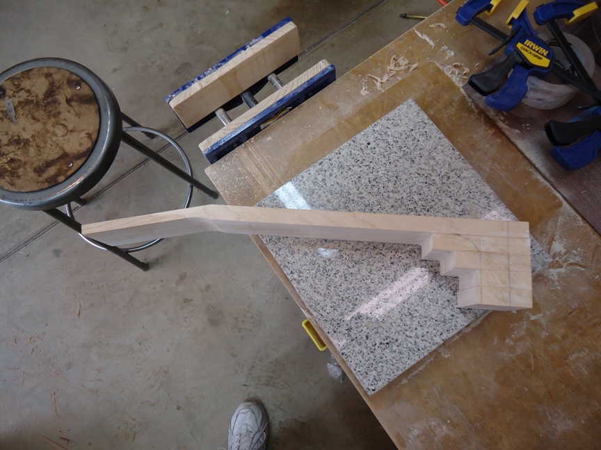

Well the maple neck just isn't going to make it. I started the layout and shaping, but I just can't stand seeing the glue lines, so I won't burn it, but I'm not going to use it on this guitar. I'll cut out a solid one piece honduras mahogany neck. I guess I really like the solid necks.....no laminations showing, no graining running in the wrong direction.
Here are some pics of the maple neck as it is.

I picked up on a procedure from the Taylor factory. Their necks are scarf/heel block assemblies -- the trick is to have a blank large enough so that matching heel blocks can be cut off the billet first before the thinner are material is re-sawn -- ie 36X3x3 cut off three 3" blocks then resaw three 1" thick blanks for scarf jointing. Of course the billet must have nice vertical grain to begin. I am not fond of the stacked heel look.
Re: A EIR Dred in the D45 tradition
I saw that Ken. They are trying to be more frugal with the wood. I was trying to figure out if I could do the same thing with a 30" x 3" x 4" billet. Two 4" heel blocks, 4 x 22" shafts. Scarf three of them, glue heel blocks to two, and do a stacked heel on the 3rd. Looks like the measurements might JUST make it with not much room for error. That would yield 3 necks from the billet, instead of two solid blanks. However, I really like the looks of a solid neck. Seams really bug me.
