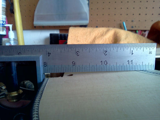

First thing we need is a picture with a combination square set to the edge of the sound hole, place the square on the rim at the neck block and measure the gap between the square and the sound board -- with that I can figure the slope angle of the top under the finger-board extension.

Gap at the rim edge is 3/16, gap at the first ring of the rosette is 1/32

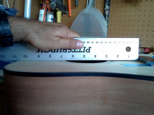

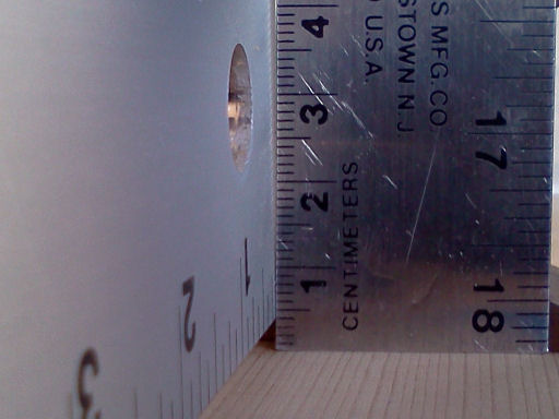

Also a picture from the side with a straight edge pushed down on the finger-board extension area (perhaps a helper again) and a measurement to the bottom of the straight edge at the bridge position on the sound-board

The first picture is of the gap that I stated was 3/16, it appears to be 5mm. I may not be clear on the other requested measurements but here goes. The fingerboard is 18" in length so halfway is between the 7th & 8th frets, with my micrometer that measurement is 6.11mm, on the 8th fret it's 7.44mm. The bridge thickness is 10.7mm. The 2nd & 3rd picutres are what I think you asked for.

Your sound board slope is more then two times what it should be -- at this point it looks like a tapered shim under the fingerboard extension may be required -- not to worry its done all the time, there's one pro here in Michigan that does this to many of his guitars -- if done correctly it looks perfect.

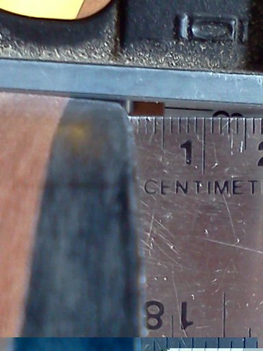

Now we need to figure your neck heel cheek angle -- a picture fingerboard plane on a flat surface, square up against the cheek --- dimension of the gap -- height of the heel
