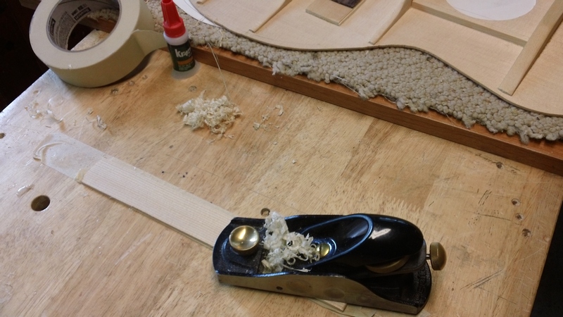

This was quick and easy - a strip of masking tape on the bench, sticky face down, a strip on the small piece of spruce that I wanted to thin, and a dribble of Krazy Glue (craft glue from dollar store, three tubes a buck, this is not thin CA) and voila!
There was no movement at all, rock solid.
The method is good for this type of thing at least.
