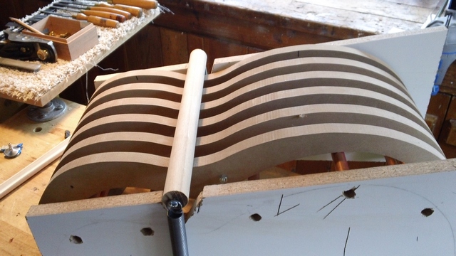

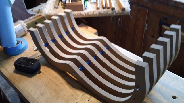

John - the first pic is my outside mold - actually a 00-12 mold from KMG that I reworked for the Terz shape - that I spread out to the width of two sides with some 1/4-20" rods and 1" lengths of some old hose. It's important to remember that the clamping of the lams is done by the vacuum bag - the only reason we need a form is for the shaping.
I could use the expanded form as is by laying the sides in the vacuum bag and pressing into the form, and clamping it all to the form.
I could also as in the second pic, load the form and bag onto the inner mold I made out of some scrap fiberboard and copper pipe - the shape is .1" smaller than the outside mold to allow for the bag and the laminates. Both ways work well, as long as the middle of the waist is in the right place and the waist area in general is really attended to.

I really like these Dave. Doing two sides at once helps ensure the raw grain of each side is laid out in proper relationship to the other. The first mold (female) looks like it would be easier to clamp to.
