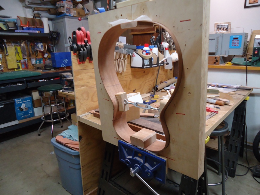

Okay the end blocks are glued to the sides, and tonight I sanded the top edge of the rims flat, they are ready for kerfing.

Have you decided on you top bracing pattern? I have a crossover in my future, so it will be fun to watch this one.
Yes, I have a pattern traced to accomodate this OM shape, and the bridge position for a 14th fret neck.
I believe it is a 7 brace fan arrangement with pretty much standard bracing below and above the sound hole. There is a bridge patch too.
John, I know you have done a couple of classicals. What are thinking for body, frets to body, etc for your future crossover?
I will go with an O0 close to what you have, but I will go 12 frets to the body, using a martin short scale. That will put the bridge in the middle of the lower bout. I use a bridge patch about 1 mm thick. It seems that there is a divide in the classical community for or against the patch. I also will use 7 fan frets.
I think the main thing to watch out for is the neck geometry, The strings are lower at the saddle than a SS. On my classical guitars with 12 frets I now pitch the neck forward slightly (the nut end of the neck 2 mm higher than the plane of the top.) In this case a straight edge on the an unfretted board would be 2 mm into the top. This difference from a SS comes from 2 reasons.
