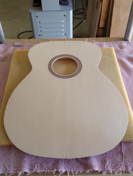

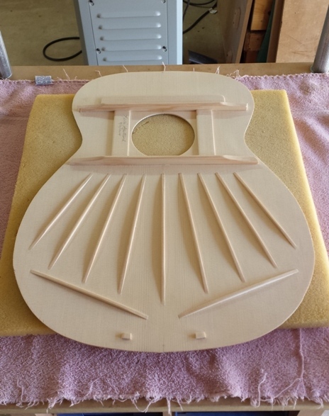

Okay so I picked out a nice Sitka spruce top and went with that. Same style rosette with the birdseye redwood. I did the top bracing the same. I has a nice tap tone, so we will see whether I did it good or not when it makes music. :>)
I did get the back glued on and the top glued on just this morning. It went well doing it in the morning when it is 70 degrees instead of 95. The glue wants to start gelling and skinning way to quickly in that heat.

Kevin - nice clean work as usual for you. Are the two little blocks for locating purposes?
That sitka looks almost as white as Englemann.

Good looking! To me (from 1500 miles away) that bracing looks little hefty for nylon strings especially with the two extra fans. -- how tall are they? Is the design from a drawing or pattern?
