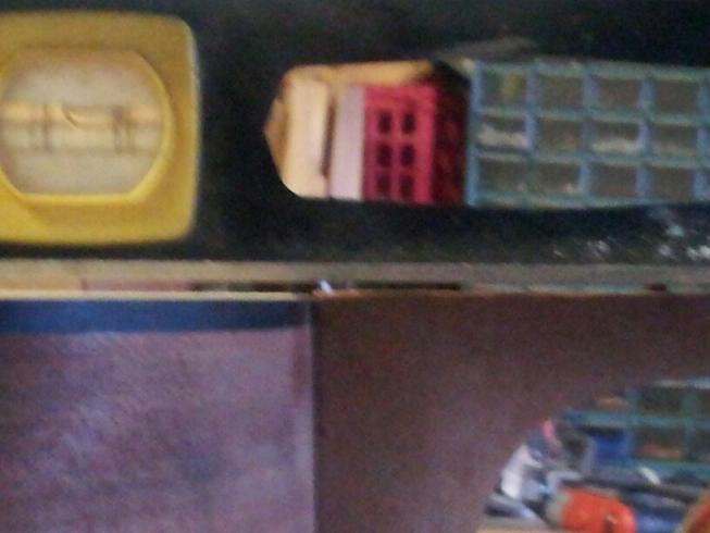

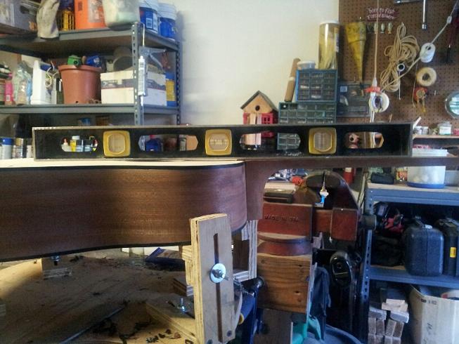

Re: Dovetail joint fit need help with correction
Post by Beau J » Mon Apr 29, 2013 8:51 pm
here is a picture with the level on the neck
i viewed probably hundreds of vidios etc on guitar building, but i would say did not get the correct information
i do know that a large portion of this is due to the neck block installed improperly, i can think of dozens of things i would do differently
as stated earlier if this is not fixable i may attempt to mount the neck any way as a learning task
the neck does not fit the dovetail mortise very well at all i did a chalk test and only get a decent chalk mark on 1 side of the tenon almost none on the other
he guitar top is flat up until right before the bridge area an then slopes off toward the tail block there is also a slight radius
from side to side
thanks for all the help and advice this will not be my last guitar
Beau

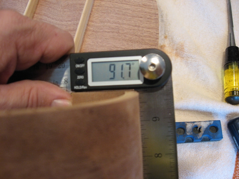

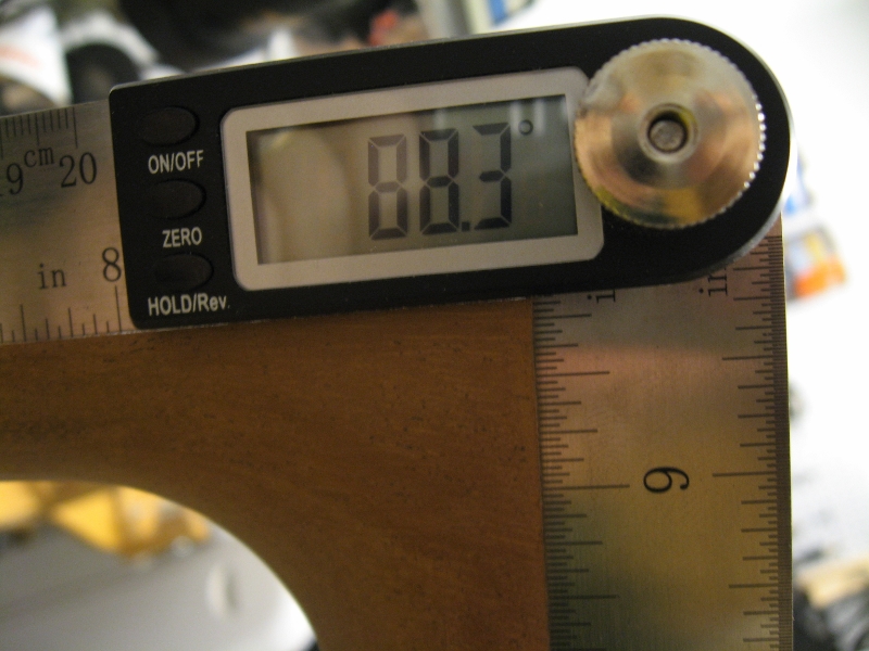

Post by Tim Benware » Mon Apr 29, 2013 10:54 pm
Can you measure these 2 angles, notice the neck angle is 88.3 and the body angle is 91.7 i.e 88.3* + 91.7* = 180*. Those were machined in at the start. You can still match those angles up. It may be a combo of adjusting the heel and flattening the top you don't necessarily need to know them to fix it but it's good to have an idea of exactly where you are off.
40 Neck Angle.jpg (338.13 KiB) Viewed 1838 times
42 Body Angle.jpg (381.83 KiB) Viewed 1838 times
