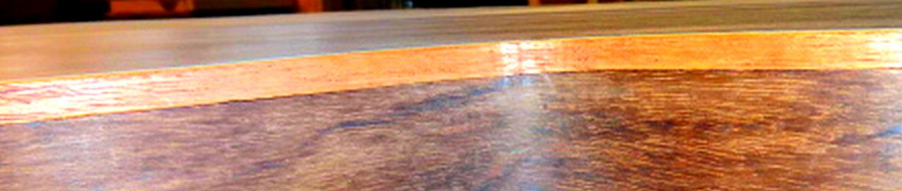

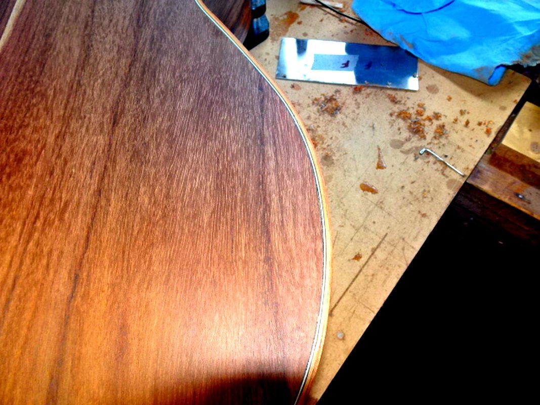

Re: router bits and chipping
Posted: Tue Feb 15, 2022 5:20 pm
by Dave Bagwill
The new jig and clean blade worked very well. Recommended.
2 x .080" strips laminated, .060" purfling. Nice and clean.
