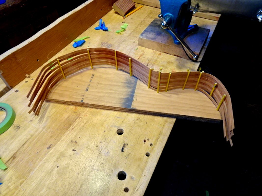

R.M. Mottolo shows a method of bending all 4 bindings at once, in his manual.
I'll be laminating 2 x .040" strips so I need 8 of them.
Still, it is doable in one pass.
I saw the idea for the overnight drying form somewhere on the net.
Leaving overnight, touch-up in the am if needed.
