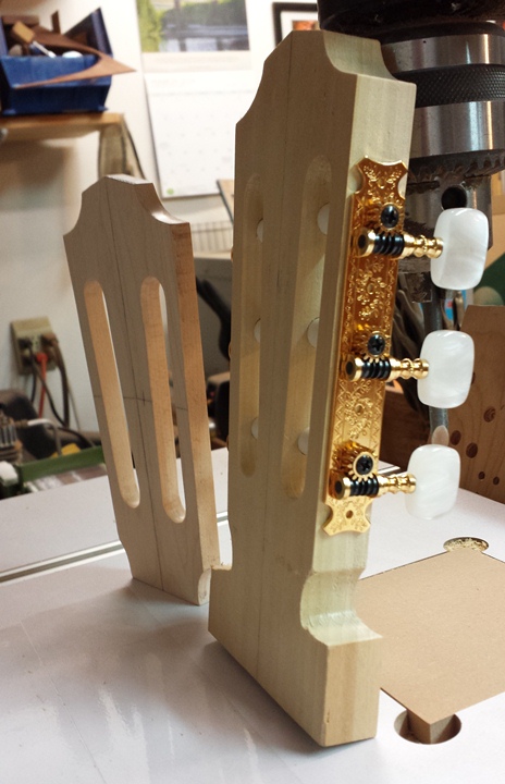

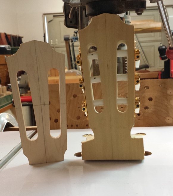

That is a nice looking head stock template. I never tried Robbie's method with the drill stock. I did use a standard 1/4" end mill once using it's 1/4" shank as the template follower. Sort of like Robbie's method but the end mill already had cutting edges.
Good to see you building again, Kevin. Quiet around the house now? You make an excellent template. Just by hand?
Yes Herman, very quiet there now. :)
I did make the template by hand, then I did a practice run routing it out with the drill press drill blank make into a cutter. I will show this when I actually the real headstock for Dave. I had a 1/4" drill blank that I used, but I think it might be a little too big, taking too big a bite when cutting. A smaller diameter bit may be better for a smoother, finer cut so I've ordered some 3/16" stock.
Here is my practice attempt. It made a good copy out of the poplar piece.
