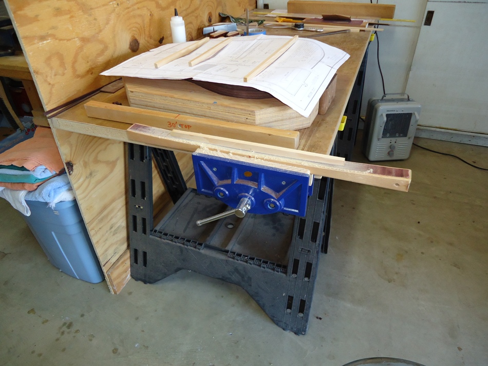

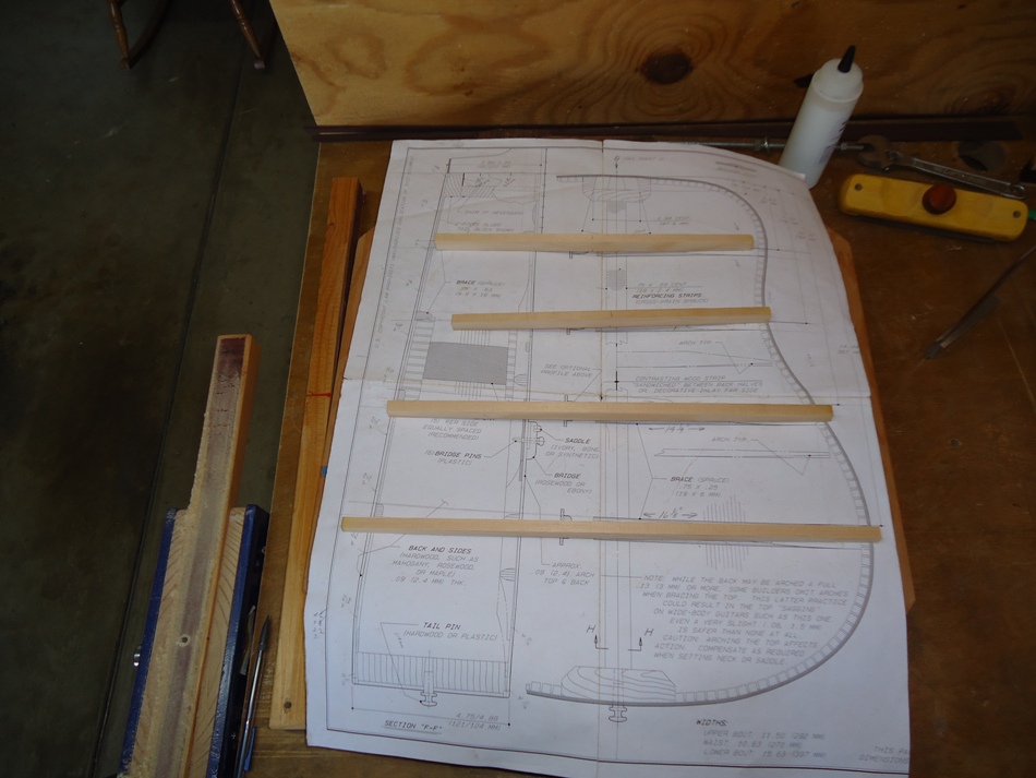

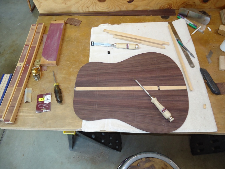

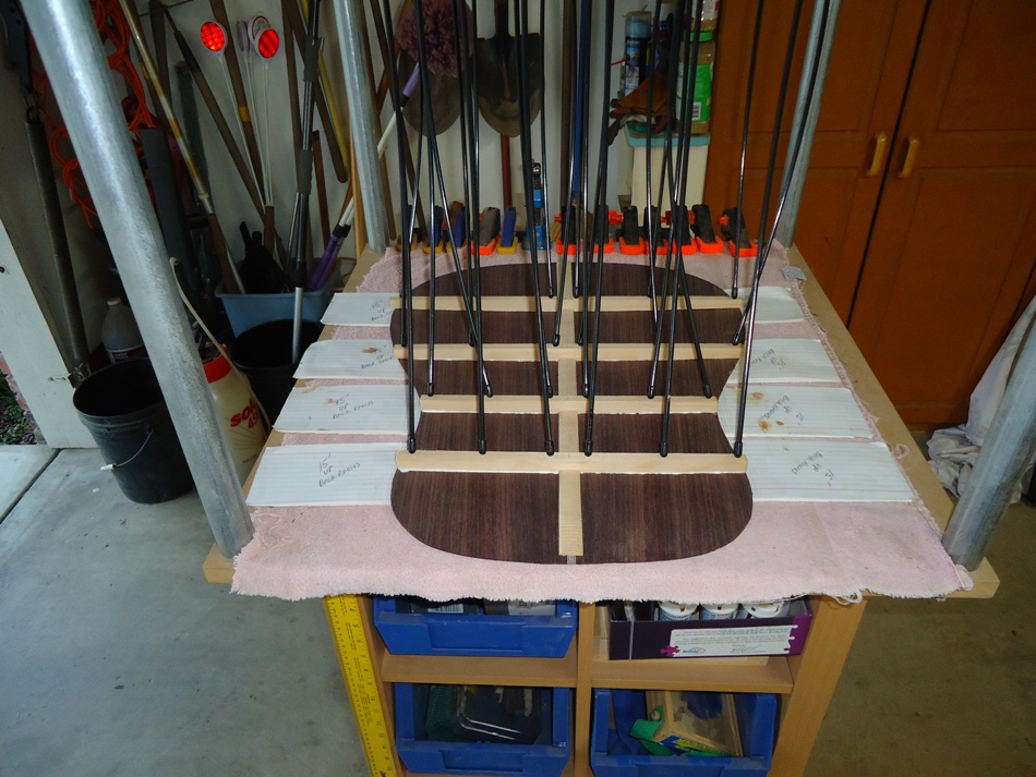

I told you this build would be going slowly......but I did get a little time in this week.
Made the center back strip out of old spruce top left overs, split some brace stock, and go the back braced in the gobar deck.
- sanding back brace.JPG (251.35 KiB) Viewed 954 times
- back braces made.JPG (197.3 KiB) Viewed 954 times
- back strip prep.JPG (253.87 KiB) Viewed 954 times
- back braces gobar deck.JPG (239.79 KiB) Viewed 954 times

Looks good Kevin. I can't wait until I'm self-reliant and confident enough to scratch build. Where did you get your go-bars? I haven't seen many places to buy them online.
George
George
Re: A EIR Dred in the D45 tradition
You can get those FG rods at any on line kite shop -- seems to me that the semi-production shops that still have GB decks use flat FG slats and or wood slats for bars.
