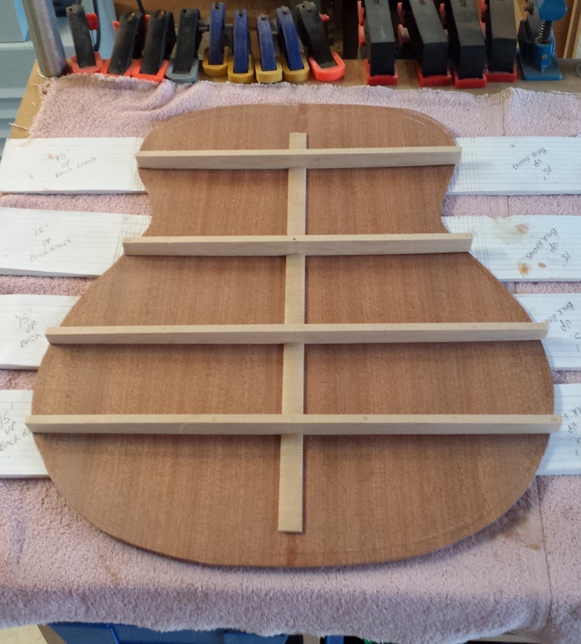

I have been able to start working on this guitar again. I have the back braced at a 15ft. radius, same as I use on my steel string guitars. They are also 5/16" wide. I will shape them at about 1/2" tall at the peak and the standard scalloped ends.

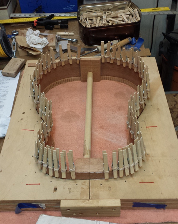

I have the kerfing in the guitar. I have the neck and end blocks currently with a radius on them, but as I am watching Robbie O'briens Classical guitar building videos, I believe what I am going to do is radius the top at 30ft and then see how high above the rims I am at the bridge area. It should be around 3/16". I am thinking if I set the neck angle flat, with a 1/4" fretboard without, I'll be at 7/16" over the saddle area. If I make the bridge 1/2" tall, then I can end up with a saddle that is somewhere between 1/8 and 1/4" tall and have a clearance of 1/8" at the 12th fret. I know this is not all exact, but I'll work with it as I go, and adjust where necessary. With the body built, then I'll approach the neck set and bridge like a classical guitar. I still think I'll but a slight radius on the fretboard, perhaps 20ft.
Still not sure about the neck, I have spanish cedar, honduras mahogany, and even sapele (which may be too heavy for this guitar, but I've seen some classicals being sold using sapele necks!!) I can use. I also not sure if I want the weight of a truss rod in there, but may decide on a two way rod.

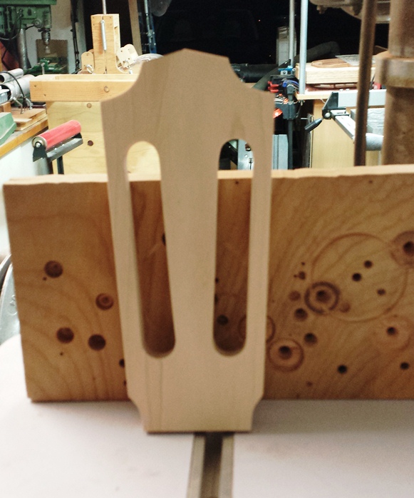

I made this headstock template last night from hard maple. I will use the technique that Robbie O'brien uses to route around the template and the slots; he uses a drill blank ground with a cutting edge on the end in his drill press.
I'm going to practice on a piece of scrap first!
- 20140807_220600.jpg (148.16 KiB) Viewed 1323 times
That's a very pleasing shape. Will you post pix of how you prepare the drill blank and then pix of the process for using it?
I will indeed.
