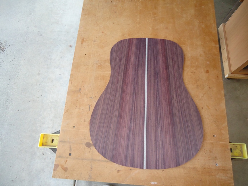

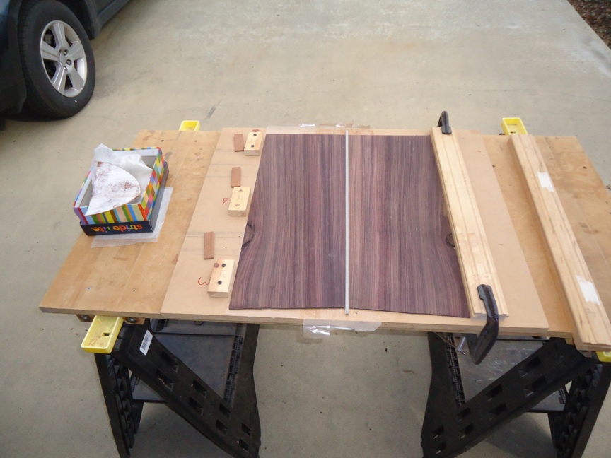

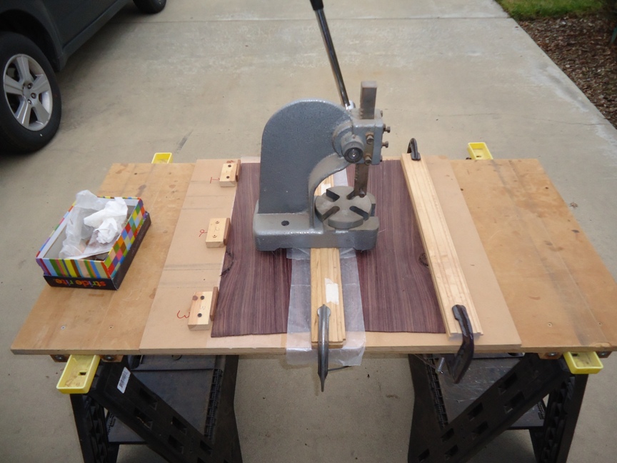

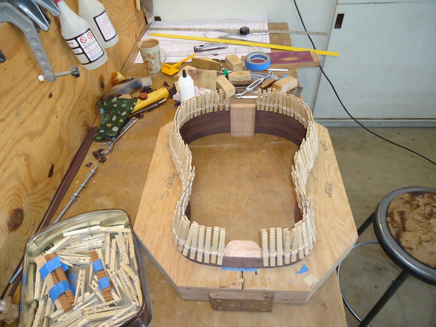

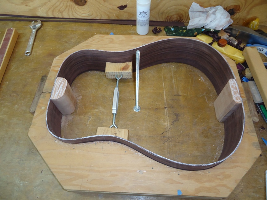

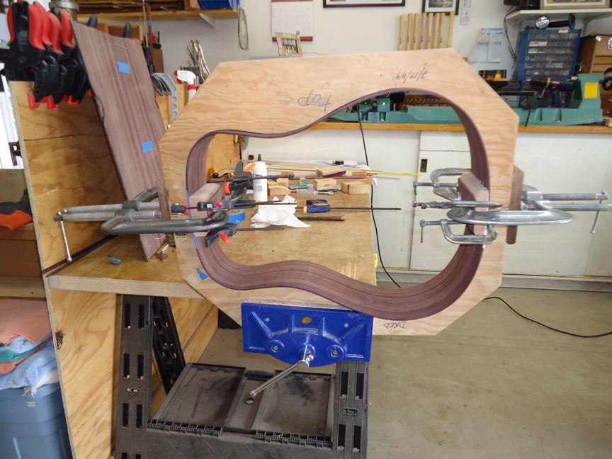

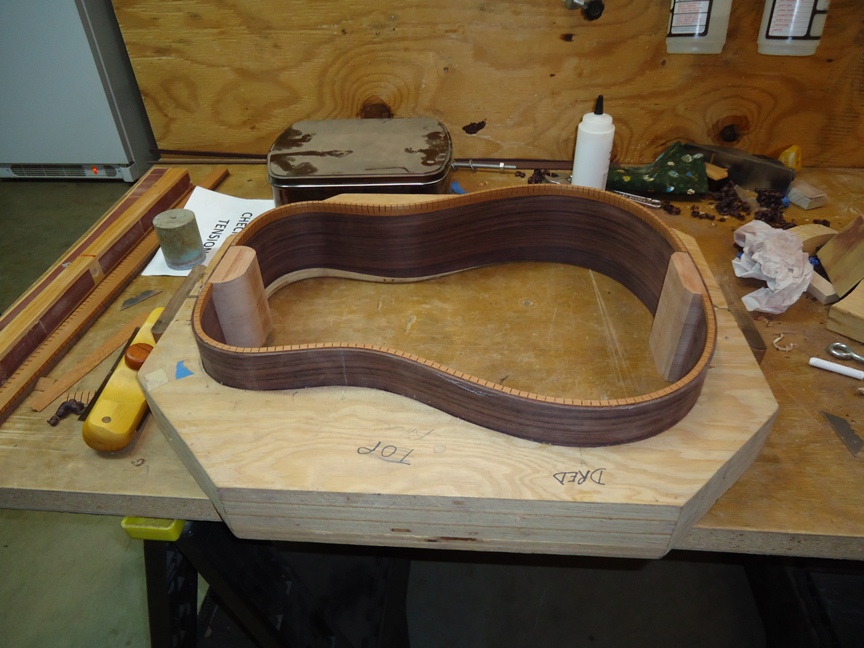

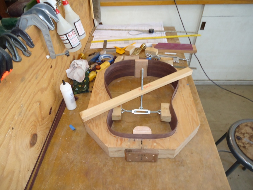

Made some progress this weekend.
Glued the end blocks to the sides, glued in the top kerfing, and joined the back plates.
- gluing end blocks.JPG (205.45 KiB) Viewed 979 times
- rims ready for sanding.JPG (210.63 KiB) Viewed 979 times
- sanding rims.JPG (199.86 KiB) Viewed 979 times
- glueing kerfing.JPG (246.75 KiB) Viewed 979 times
- top kerfing in.JPG (205.9 KiB) Viewed 979 times
- back panels glue 1.JPG (182.11 KiB) Viewed 979 times
- back panels glue 2.JPG (182.83 KiB) Viewed 979 times
- back sanded ready for bracing.JPG (188.46 KiB) Viewed 979 times
Re: A EIR Dred in the D45 tradition
You've got a really attractive back, Kevin. :-)
