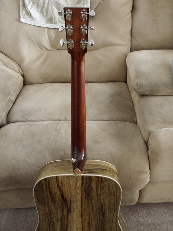

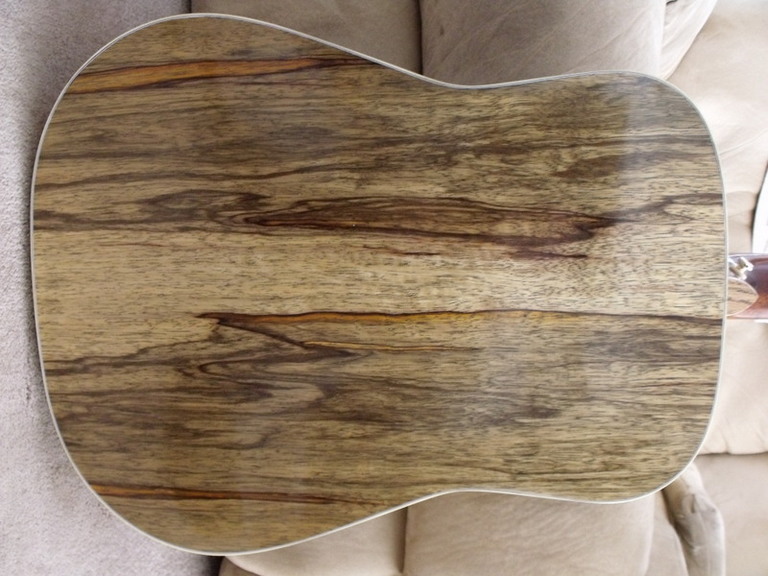

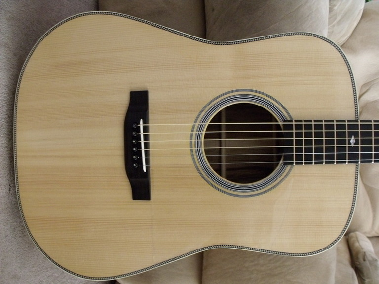

I know space is limited so I'll only post 3 pictures. The neck is what started this whole thread for me so I included it too. The top shows how the Egg White sizing turned the top from a bright white to an antiqued look. The back shows how well the wood shows through the shellac.
For anyone following this thread that wants to try shellac for the first time, the most important DON'T DO I learned is to let the flippin thing dry for a good 3 days or more before fiddling with it. It may be dry to the touch after a day but is isn't dry enough. I put the neck on, strung it up and played it for 15 minutes or so. I put it on the workbench to fine tune the action and I saw fingerprints nicely inlaid into the finish just below the sound hole where I anchored my fingers for some finger pickin!! I was able to fix it with alcohol (another really nice thing about shellac) but it was a needless, time consuming repair.
Thanks for everyone's help!! I'm happy with the final result.
