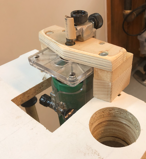

I mentioned that my binding channel rig was "inspired" by Ken. It's not the same; my recent builds all use a strong Manzer wedge as well as a 12' radius on the back. That means that the binding channel depth and width must be defined very close to the corner of the side and the back (or top). My rig holds the router vertically with a narrow (~⅛" before a roundoff) shelf to position the back or top (which faces down when being routed) and a small (~1") "vertical" affixed to the router to guide the guitar side. The arrangement follows Ken's approach of "maybe cutting too little, but never cutting too much." Repeated (and repeated and repeated) passes make the whole thing work. And after the first pass or two, the direction of feed is unimportant as the router bit only skims the surface. I know that I'm done when the sound doesn't change as I move the guitar around.

Regarding the router bit, I use a ⅜" diameter single-edged carbide bit with a slight skew. I'd share where I got it -- but (like so many other things) I don't remember.

Looks good to me. 'Sneaking up' on the final cut is my preferred method :-)

If I could do that, Herman, I would be a happy man. Do you think that the fixture you use is the key?

Post by John Parchem » Sun Jan 30, 2022 3:27 pm
Herman wrote: ↑Sun Jan 30, 2022 2:29 pm Well, I take it off in one pass, with the matching bearing.
Works for me. OK, most of the time.
But I could try a two step method.
Hermnan
