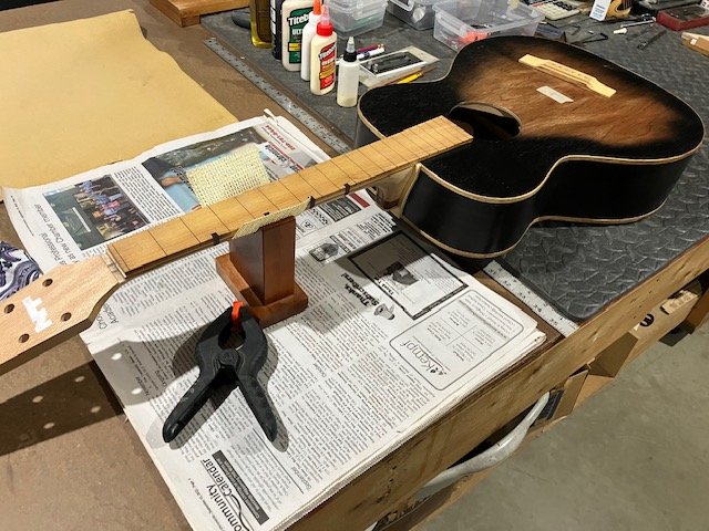

When my Pam died in February, 11 days short of 81, I had just about completed a prototype for a 14 fret OM guitar with a wider X brace like my two prior “Norman Blake” long-scale 12 fret builds, #9 and #11.
The incomplete guitar needed the bridge glued on, tuners, a nut and saddle, and the end pin. I left the components with my luthier friend, Kjell, to complete and mail to me, as I moved from Michigan to Texas just after Easter. I'm now in a senior residence place with about 150 apartments and 2 miles from my daughter and her family. Without tools or work space.

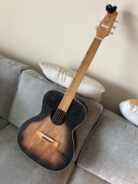

I received the completed guitar shipped to me yesterday.
Kjell's fret end finishes make mine look incomplete. He glued on my bridge, made saddle and false nut from my Corian blanks, blending in the intonation on the saddle smoothly instead of filing separate notches like my crude method. Added some open tuners - I thought I left him a couple sets of the C.B. Gitty ones, enclosed, that I used to use, but I like the white pearl buttons.

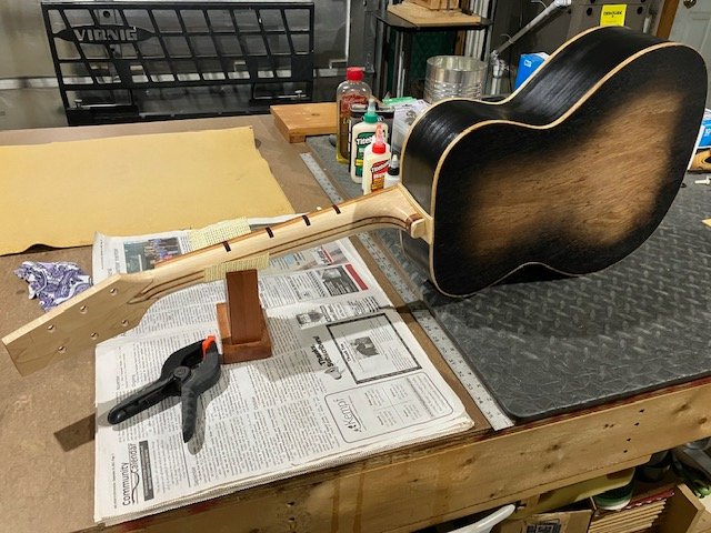

Had yet a 12" piece of 1/4" x 1/2" steel left from neck braces of the 3rd and 4th builds I did. Used that instead of a Stew-Mac dbl action truss rod, so there ain't gonna be a quick adjustment for this one.
The neck I'd started for #6 but somehow managed to ruin twice. First I made it too thin, then I undercut the cheeks of the tenon before I should have. It had my usual homage to Antonio de Torres Jurado, a Spanish V-joint for the headstock.
Was going to throw it away but decided to keep it on the shelf to remind me that guitars have to be built each step in a certain sequence.

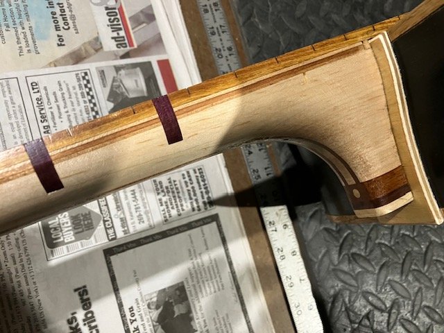

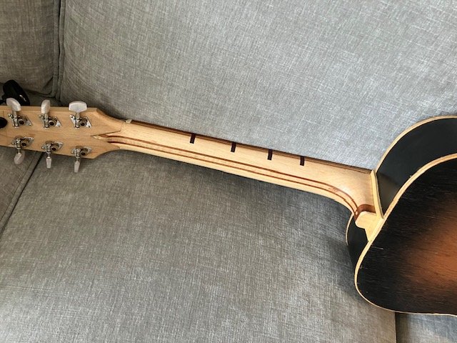

I glued on 3 layers of thin wood, mahogany, cherry, and maple, to make the neck thick enough before adding an old osage orange fretboard I'd made years ago, flat, not radiused.
The bridge is osage orange, also, from the same down branch in a fence row 1.4 miles north of my old farm that the owner let me have.
In order to maintain the 14th fret at the body join, I cobbled up a piece of 1/4" plywood like a collar shim to permit me to recut the undercut for the tenon cheeks at the proper angle.
Usually I just add side marker dots to a fretboard, as I had one of the first Formica Martins (made in PA, not Mexico like later) for fifteen years and never realized it didn't have dot markers on the face of the fretboard until I traded it in for a Martin, because I don't look at it while playing, just the edge. This time I had scrap purpleheart, and did dual purpose fret markers visible from both side and face of fretboard.

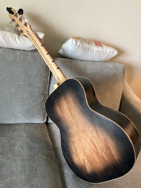

First coat of finish was a sanding sealer, then routed the binding rabbets. Doing this tore a little of the top and back plywood, so sprayed on some flat black paint on the sides and used same for sunbursts on soundboard and back. Added red oak bindings, not scraped flush, and then wiped on a couple coats of satin urethane.
Yeah, it's rude and it's crude and for two days playing, it doesn't sound bad for a 6mm sound board, but with that same material on the back it's heavier than most.
6 photos: 1,2,3 are where I had it, A/B/C are Kjell's completion. Will hopefully make a sound file to add in a couple weeks when it's played in some.
