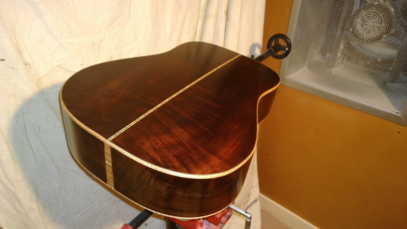

Made some progress this week. I'd gotten the wrong shellac, then ordered and got the right shellac, then read more and more where there were problems with the shellac and Emtech 6000. Of course, I didn't read the right stuff until I'd put some on. But one coat of the shellac, and I started sanding it back. It felt waxy to me, even though it was de-waxed Zinsser sealcoat. I had emailed the guy at Target, and after his response, I decided to forego the shellac coat. So I used denatured alcohol as he said to do, and then started spraying. Of course, mother nature got in the way and I had to stop for over a day. But, now I'm spraying. I got 3 coats on Thu, 5 coats yesterday and will do 5 today. I leveled after the first 3 because of the gap in time. Then wiped with some DNA and did the 5 yesterday.
Here's how it looked after sanding back yesterday's coats.
Then after the 2nd coat today.
It did take a good while to sand back to level on the top and back. Surprisingly for me the sides went pretty easily. The troji came in handy for that part.
I'll probably do the 5 coats today, then sand tomorrow, and 3 final coats on Tue nite.
Can't wait for it all to cure.
