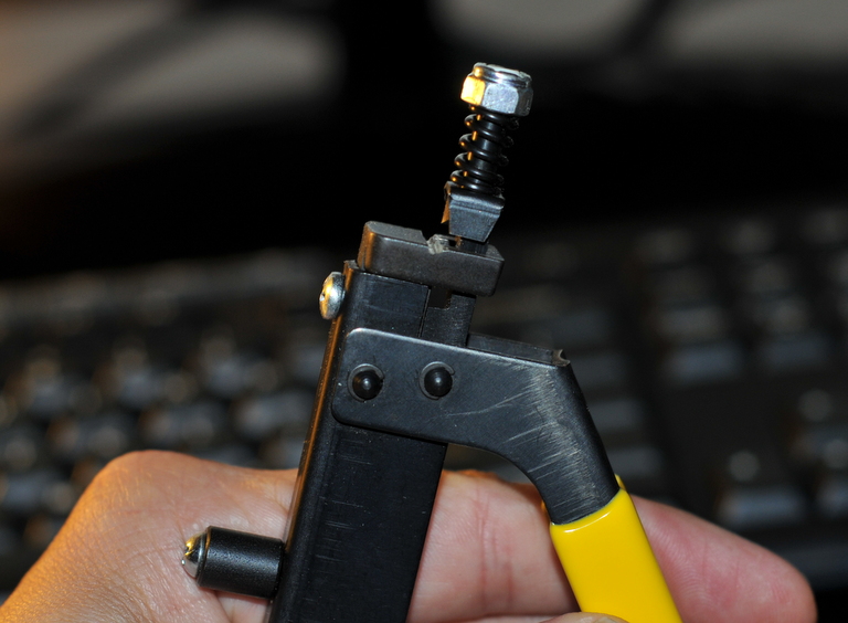

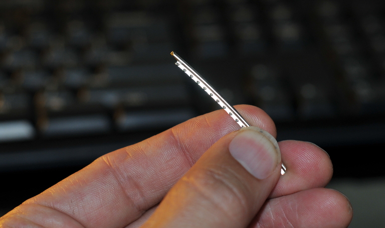

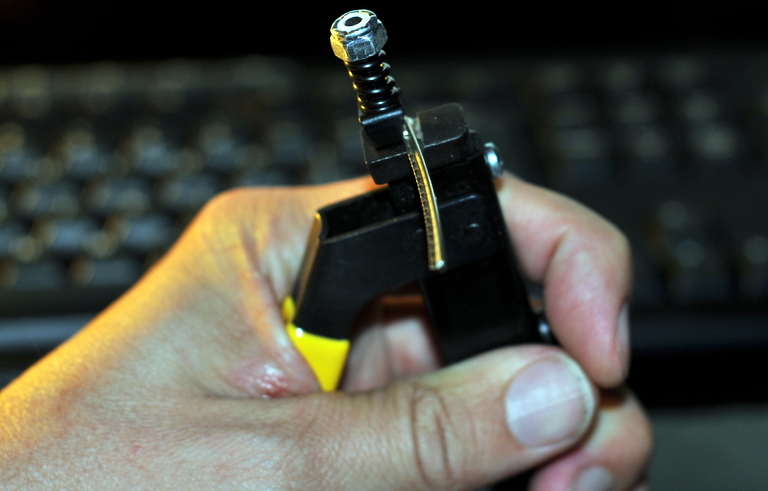

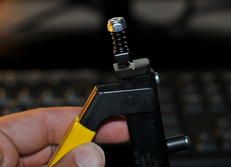

Re: Installing frets on a bound fingerboard
Post by dave d » Thu Jun 20, 2013 9:50 pm
I couldn't find the nibbler at Radio Shack so I ordered the Klein Tools version from Amazon for about $25.
I cut a slot into it with a dremel and a cutting disc.
The fretwire lays on its side in the slot so that the tang is under the blade. And voila.
